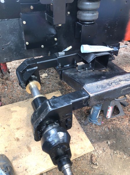

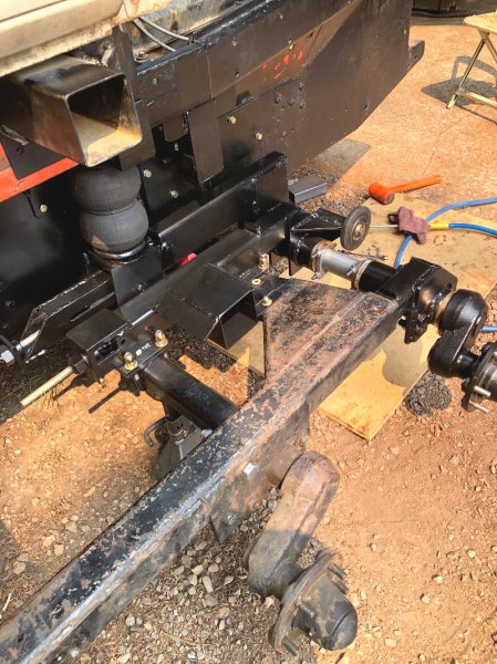

    I have been working very hard (Subjective) trying to get as much work on the snow cat project completed as possible.
    Just a lot of re-designing work on the front axle/s
    Totally new design that just took a great deal of time and fooling to get it right.
    The past couple days have been spent going through all of the road axle hubs and replacing all the bearings.....(These are in the same class as boat trailer bearing hubs....R&R at the end of every season....or they rust up due to water infiltration)
    I have two hubs left on the LH side to go through......

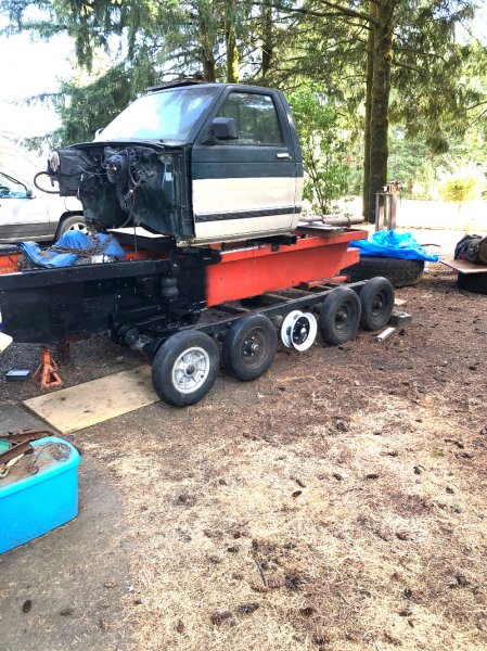

    Decided a few days ago to go back to the original plan of putting a Chevy Astro/GMC Safari body on the cat.....
    I really love the room and passenger capacity and comfort of these small Vans.

    A few pics
    The LH front axle assembly with air bag suspension
    Things back together and getting the road wheels back on.
    The tires are pretty shaky....but will do until the rig is ready to get its tracks back on.

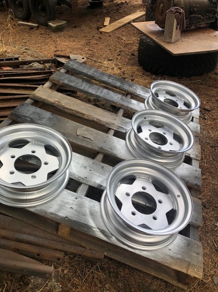

    I ordered up a few new tires to fill in where we have empty spots.
    The odd White wheel (Now silver) are customs that I had to put together.
    The wheels are 12" and the centers have 5 hole on 5-1/2" pattern.
    This is an odd duck that was made special and is not made any longer.
    So I designed the "Snowflake" centers and had them water jet cut from 3/8" steel plate.
    The white wheels are a standard 12" trailer wheel that is available today...
    I cut the center plates welds loose and toss them.....The new stuff is 5 x 4-1/2"
    Then fit the new centers and weld in place.
    The other option is a new aluminum wheel hub hybrid that is made....$600 each
    NOT GONNA HAPPEN...
    The front wheel on the cat is that type....and were standard on the fronts.

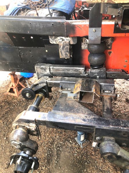

    A piccy of the RH assembly completed.....
    Both are now independently adjustable to tighten the track.....(Before it was a straight axle across)
    Big reason for the change....these axles are no longer available and most used stuff is junk....

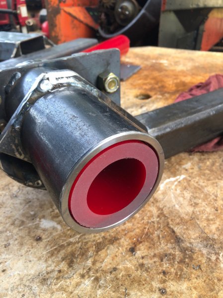

    Decided to cannibalize the old axle, and to reuse the spindles and housings and then build a complete air bag articulating assembly for each side.
    Parts are readily available and easy to work with...
    The axles are suspended in two large red urethane bushings on each side.....(Standard off the shelf stuff that was available locally)
    Air bag is a rear axle kit for a Dodge pickup.....Modified of course for it's new assignment.....But still readily available and reasonably priced.
    Other than the original outer track adjuster slide....everything else is all custom built to fit....and do it's job.......
