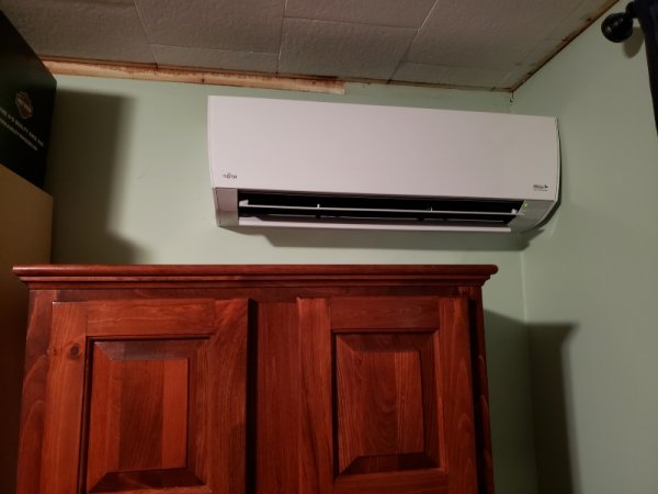

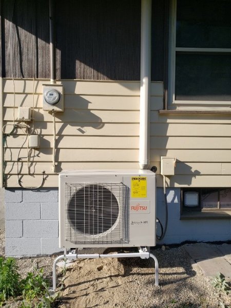

    Fujitsu. Keep in mind, that I went with more than what this place should need according to the 960 square footage. Most people that quoted told me one 12k head in the living room would be fine for the entire house. However, I have 3 large bay windows (south and west sides), I get full sun on the south and west sides (with the top half of the siding is painted a dark brown), 2x4 construction so only has R13 insulation, low ceilings and a low roof.

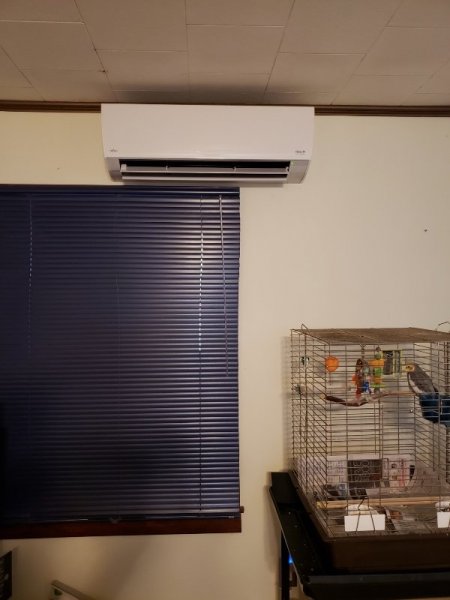

    Additionally, I wanted to ensure that my office was comfortable and wanted a separate head in there - it is out of the air flow and heats up quite a bit with the lights and electronics. So, I made them quote at least a 6k head in the office. So, all the quotes offered a condenser anywhere from 20k to 30k btu (depending on brand). The Mitsubishi quote had a 6k unit in the office, the Lennox quote had a 9k unit in the office and the Fujitsu quote had a 12k unit in the office (with a 15K head in the living room).
    I went with what others would call overkill: 24k condenser with a 15k head in the living room and a 12k head in the office. Now I'm sure that a 9k would be fine, 6k I'm unsure about. The Fujitsu guy was also the only one that suggested putting the living room head as far over the window as possible for the air-stream to be somewhat toward the bedrooms (can't do directly over because of the header). Everyone else wanted to place it in the corner by the front door, which would aim it at the wall on the other side of the LR - I know what happens to the air that goes there (from having the Hastings pellet stove), and it just don't move without a ton of fans). The tubes go out the back toward the right side of the condenser so misses the header.
    The condenser is directly below the LR head.
    The office head - the tubes go out a knock-out on the right side of the unite
