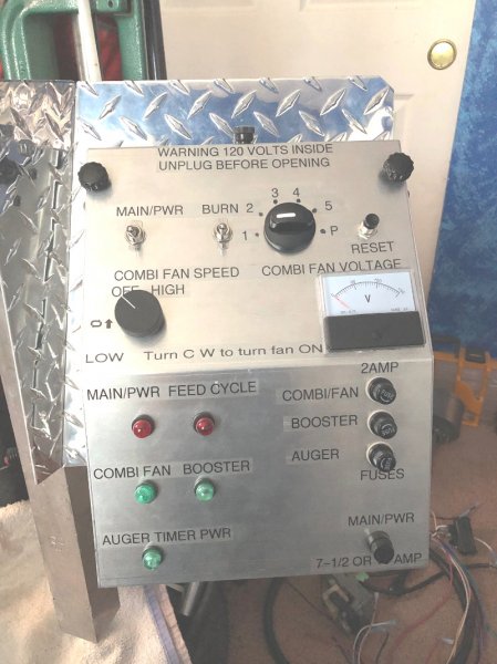

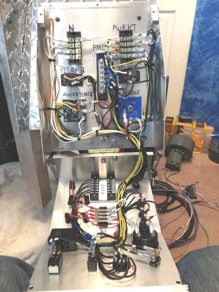

    Got after the new control panel with a vengeance today...
    Waiting on two resistors for the heat control assembly, but they are an easy couple minutes to slip in and snug the screws down
    I needed a 1 megohm and an 820K ohm resistor for the #1 and # 2 heat positions.
    I had ordered 1/2 watt parts and the clown sent me 1/8th watt...
    I had not opened the package until today as I was not ready for them..... arrrrrrgh :picard:
    Only about $4...oh well..
    Otherwise it's ready to plug in the test motors and let it rip.... :yes:

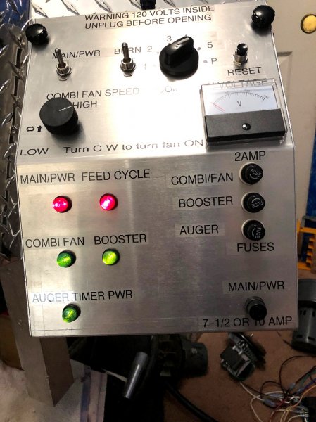

    Finished up with some last minute serious Whupazz on the new controller this morning.
    Plugged that bad boy in and all was quiet (AS it should be)
    Pressed the Reset button (Still all quiet as it should be )
    FLIPPED THE MAIN SWITCH Yessssssssssssssssssss
    Panel lights (Main/pwr..Combi and booster) come on (As they should)
    Booster fan comes up to speed (As it should)
    Twisted the Combi fan speed control and the combi fan spools up ( As it should)
    Flipped the Burn switch and the cycle timer starts cycling with the Red lamp blinking off and on with the feed setting (As it should)
    Checked the various heat settings and everything is in the ball park

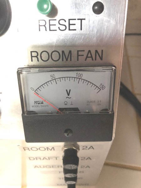

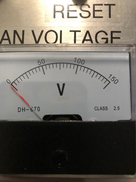

    Then I noticed that the panel volt meter is not reading ????????
    Grabbed the VOM off the desk and checked the voltage at the meter terminals.
    Reading perfectly ???????????????????
    Shut the unit off and swapped the meters. Nope...same issue.
    Scratch head and wonder WTF
    Same meter I used in the Panel for the Big stove.
    Arrrrrrrgh.
    Puzzling over the debacle and then I spot the issue.
    The Meter has the big V in the face but not the Alternating current mark under the V
    Both meters are the same...
    EBAY from across the pond (China)
    I ordered the correct meter (0-150 volt AC )
    Somebody grabbed the wrong chit and tossed it in the box.
    I now am the happy owner of two 0-150 volt DC meters :picard:
    New meter coming from a different vendor
    Testing is going well.
    The 1 megohm resistor is a tad high ( 1.04) and as such the timing is a tad long at 11 seconds.
    May switch to a resistor in the 900K range (Each 100K is one second on the timer)
    I had ordered some 820K ohm resistors and they were marked wrong on the package and what I got was 866K Ohm (8.6 seconds off time)
    Easy to swap these out...takes a couple minutes to change them.
    No need now as the testing can continue with the current parts.
    When we get to prime time I want the specs spot on for the best fire control.
    Some pics...

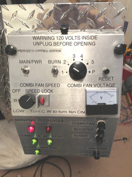

    Panel testing pretty much all day now and working sweet.
    Decided that the fan speed control needed a LOCKING DEVICE to prevent accidental adjustments.
    Machined a cool little aluminum angle and drilled and tapped it to allow the small red knob to screw in and lock the speed control easily.
    That bad boy will keep any unwanted adjustments at arms length for sure.
    I ordered up a little bigger selection of resistors to be able to fine tune the heat ranges.
