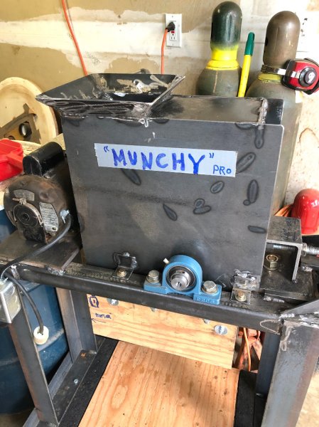

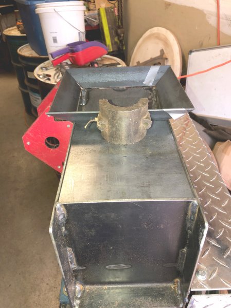

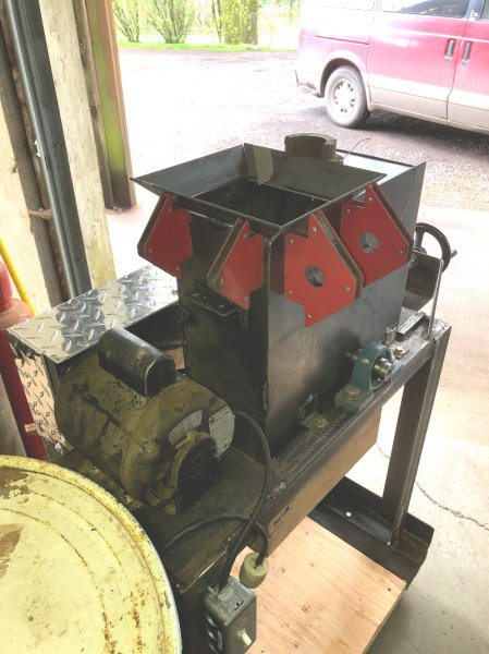

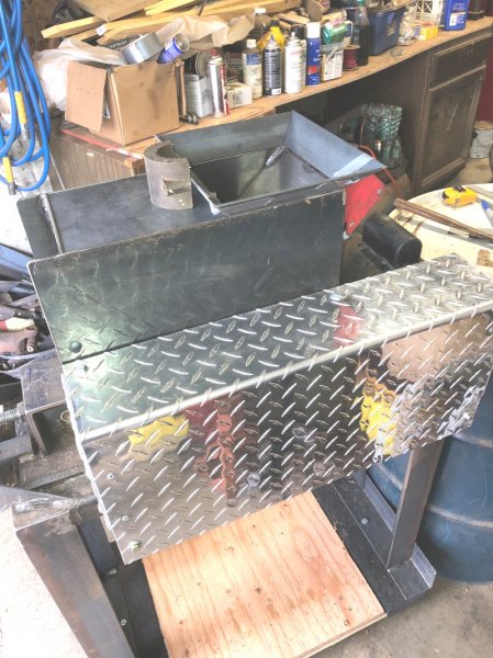

    Yesterday I got after the mods on the Munchy hopper.
    From the gittgo we had to place a piece of wood over the very front of the hopper to stop the occasional half shell from flying out (Happens often and makes a mess on the slab.
    Decided to add a piece of sheet metal to that area and just weld it in.
    Pouring in the shells using a large plastic scoop would also see a few half shells fall off the edge of the scoop and make it to the concrete as well, so decided on a 2 inch wide sloped flange around the opening to hopefully stop this as well.
    Cut and fit all the pieces last night and then removed the hopper from the machine to make welding easier without getting splatter all over the machine.
    Some pics of the materials mocked up.
    This morning I will get after the welding job..
    These mods should make feeding the machine easier as well as keeping the work area cleaner.
    Weather is looking good for Thursday.... hopefully we can run Munchy and get more materials done.
    I'm thinking that after the current mods are done today and the machine run again Thurs. that it will be PAINT TIME :thumbs:
    A couple rattle cans of paint and Munchy should look good....

    Ripped MUNCHY apart and added the modified top and welded in the belt guard bolts.
    Cleaned off the anti splatter spray goop and put the beast back together.
    OWG.... it works sweet....
    The hopper flange reduced the spillage by over 90%..
    Definitely a lot less stuff to sweep off the slab after a session..
    Had one jam from a chunk of wood (Piece of tree limb most likely)
    Here is a video
    A few more pix
    AS far as I am concerned this bad boy is ready for the paint job.
    Get some warm dry weather and I will gitterdone.
    Need to fully disassemble the machine and clean it well with a good grease/oil remover and then shoot it.
    In the mean time this bad boy can "Do it's job"
