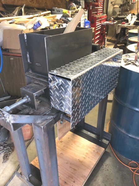

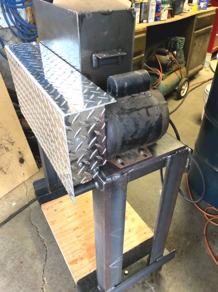

  18. Snowy Rivers
    Snowy Rivers
    Nov 15, 2015
    2,854
    12,510
    Newberg, Oregon
    Bear.... naps are a good thing .... :D
    Today's weather sucks...we met friends for breakfast and came home...
    Decided to finish up the belt guard on Munchy.....The main guard was fine, but the ends still needed caps to prevent an INCIDENT.....
    I fastened the motor end on permanently with heavy pop rivets, but the other end needed to be removable to gain access to the hopper side bolt that holds the guard.
    Drilled and tapped the aluminum angle on the cover side and bolted the plate on..
    Scared up enough scraps in from the corner and searched drawers for the rivets.
    Should be quite safe now.....
    After we get a bit of nice weather and maybe a bit of xtra time we can paint the beast....
