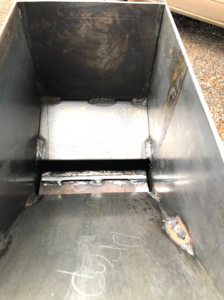

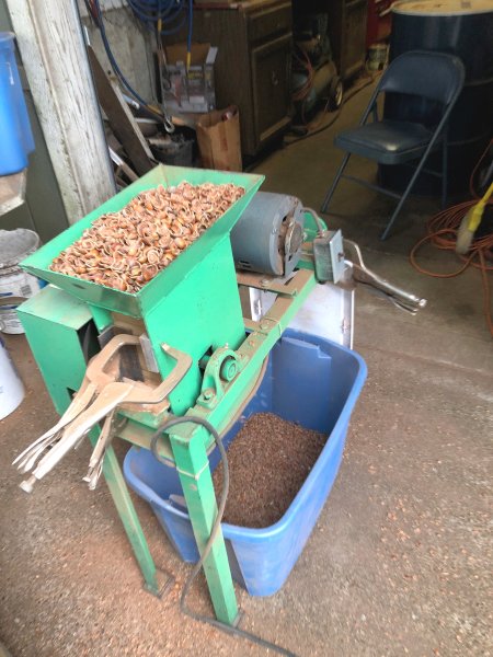

    I will give you the long story.
    The shells we burn in our stoves used to be a nice even small size (Pinky fingernail for reference) This past summer due to new food safety laws the company we deal with built an entirely new facility with all new machinery.
    The new plant machinery does a fine job of cracking the shells into cute little 1/2 round pieces.....
    Sadly this size of material does not work in the stoves..
    Also the stuff is very light in weight by volume in bulk when hauling due to the vast quantity of air in between the loose round hollow nature. (Reduces my hauling weight from 2700 pounds per load to no more than 1600 pounds.
    The plant manager knew the issue when the new system was started up and advised us of such.
    He offered to loan us a portable "cracker" that could be adjusted to reduce the shells to a more even "Usable size"
    We named the machine "Munchy"
    We were able to use the machine up until March 18th when they needed it back for a sampling job (That's it's use...sampling nuts from customers prior to quoting them a price per ton
    Sooooooooooo.
    The plan is for the company to reinstall their old shell removal system this summer...
    The official word is "into next season at the earliest"
    I decided not to wait until the other shoe drops and maybe for whatever reason the change gets delayed or ????????
    Borrowing the company machine may not be possible when we would need it next fall, and the plant is going to operate until the end of May.
    After we returned the company machine "Munchy" I started designing and building our own machine.
    GREEN MACHINE.....Borrowed "Munchy"
    OTHER PIX.... My creation
    This is now officially.... Munchy

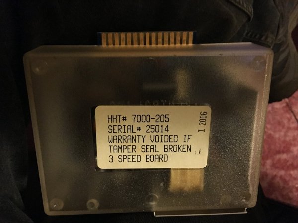

    These Quadrafire stoves really crank and are good to work with. This is at the least, my 4 th one I picked up. A lot of panels to paint! I wish I could keep one of these someday!
    They go quick. :-(
    This one needed a good cleaning on the jambed auger and a new CB.

    Wow, you are amazing to fabricate that!!! Good Luck with it!
    Does it have a grinder type blade that needs sharpening once and a while???
    Also will that work on Acorns?
    That would be a lot of FREE heat around here!!!
