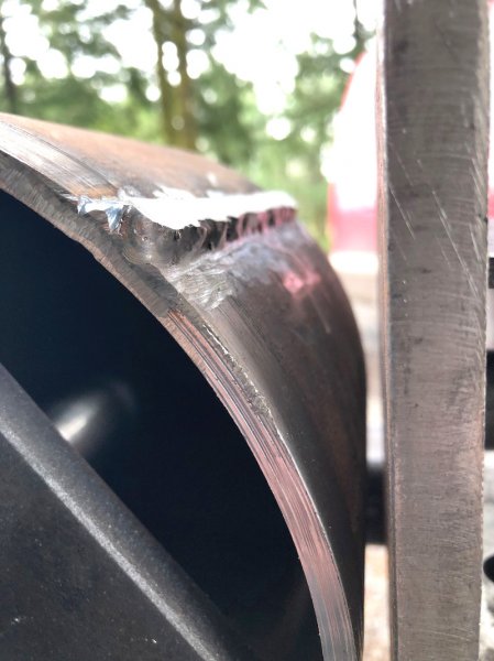

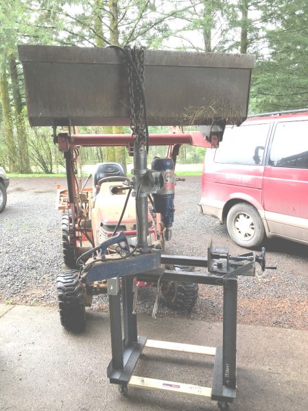

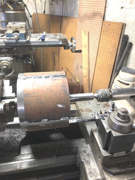

    Yesterday was productive on the Munchy.
    Dug out the BAD AZZ mag drill (Had not used it in years) this bad boy is just plain heavy.. so rigged it with the tractor and got it up on the frame.....
    Drilled the bolt holes for the main shaft bearings with ease...
    Welded the shaft into the rotor assembly.
    welded the impact bars (1/4 inch round rod) to the rotor assembly at 4 postions.
    To achieve a nice clean fit and good clearance control against the anvil I tossed the rotor back in the lathe and machined the OD of the bars to get the clearance down to about .150" .
    The rotor is large enough that it will not clear the carriage on the lathe, so a workaround had to be done..... a long boring bar in the tool holder and machine to just beyond center and then flip the rotor end for end and machine the other side... A ROYAL PITA but it got the job done.
    A good close up shot of the finished impact bar and the anvil
    The welded front surface has the weld all the way across the face and the trailing surface is skip welded just for stability.
    I got the beast bolted back in and the pulley bolted on.... Sitting there looking at it....I was curious... I grabbed a couple handfuls of half shells and then spun the rotor pulley by hand and tossed the shells onto the top of the rotor..
    KARUNCH...... All sorts of nice little pieces flew out the bottom.. :yes:
