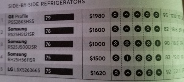

    This is from the Consum. Rep. "Buying Guide" book. The #3 Samsung was rated a "Best Buy".......

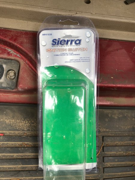

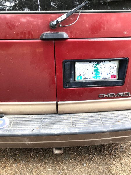

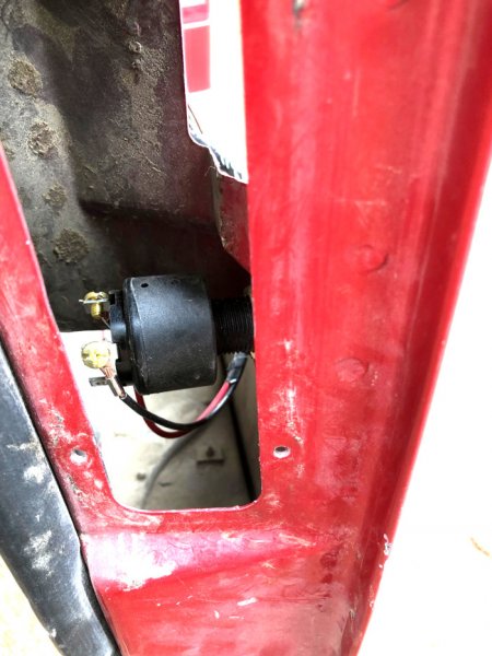

    Been working on the Astro Van getting the little crap fixed.
    The rear hatch switch in the lower RH door (DUTCH DOORS) 1997 model was non functional and a trip to the MA GENERAL STORE (CHEVY DEALER) was a zilch zip nada.
    No longer available.... soooooooooooo headed to ebay and other net based sources... no luck either.
    Decided that I was gonna have to do an end run and McGiver the thing.
    Headed off to the Parts house and found a MARINE ignition switch (Has a outer rubber seal over the key is about the only difference plus the case is a polymer instead of metal.
    Sweeeeeeeeet...the one I found slipped into the original hole in the door perfectly and was not too long overall.
    Even the recessed panel in the door that the license plate goes in (And has the hole for the key did not need to be modified)
    A couple lengths of wire added to the original plug got things all hooked up.
    THE ONLY caveat is having to add an extra key to the fob :picard:
    Sweeeeeeet...just like downtown...:yes:
    With the older rigs just getting older, many parts are just not available any more, especially the little crap that was an OEM only.
    This fix took maybe an hour from start to finish.
    $29 for the switch.
    Great to be able to open the hatch without having to crawl in the rig.
