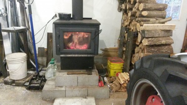

    finally lit off the wood stove in the shop. made it cozy in no time.

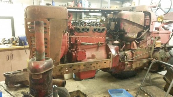

    so I could continue to work on this 450 Farmall
    it appears that the air cleaner in the foreground (notice the indent in the top) allowed water to accumulate and then seep in through a pinhole. the result was that the accumulated water pushed out the oil that is supposed to be in the bottom, but more importantly, when the tractor was started water vapor was sucked into the motor. now it only ran long enough to unload it at my shop for some minor repairs. while it was waiting its turn, the water rich environment in the combustion chambers stuck the motor. i'm about to pull the pan so I can apply some pressure to the pistons from below. failing that, it's off with it's head!
