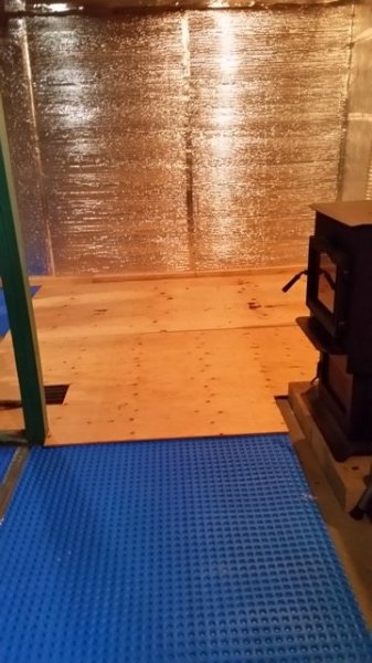

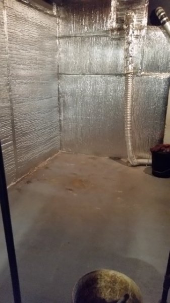

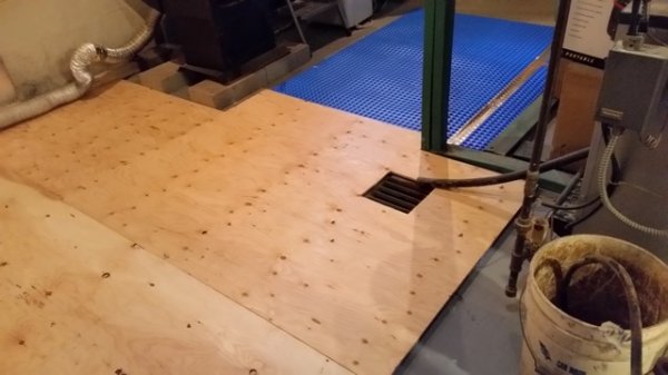

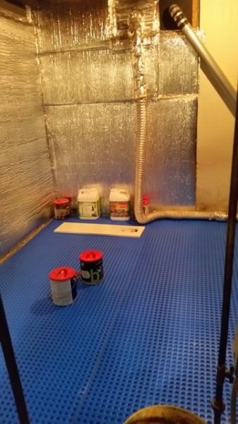

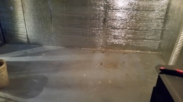

    My project for today was to do more work on the basement (which I haven't worked on in quite a while. I figured I had very few bags of pellets in the house, and before I moved more in, I would extend some of the flooring so that the concrete is covere. Two pics of the floor once I got the pallets and pellets out, one pic of the air Gap system** (allows any moisture to move out underneath, and two of the plywood - one whole sheet and the other was done in one cutting!!!! I did finish out with plywood over the rest of the Air Gap System, just didn't take any pics.
    ** please note, if using the Air Gap System, taping between the seams to keep moisture from penetrating is a must - I just took that picture before the taping was done.
    Hey don2222 - you were asking about putting in a floor in your basement - this is one way.

    Look'in good , what are you planning on putting over the plywood ??
  3. bogieb
    12,547
    76,318
    I have a 5x8 scrap piece of white linoleum that I have laid down and letting it relax. I'll just leave it loose lay - it's not quite big enough for the entire space so may change it out in the future when I get the rest of the floor put in.

    Oh, then of course I have to put in non-combustible materials in front of the stove and the boiler - haven't decided exactly how that is going to be accomplished

    Um, that is the P61a :D I don't have anything in front of it at this point besides plywood. Those are 12" cinder blocks that stove is on and they don't stick in front of the stove. Of course I "could" just put brick there, or tile, or rock, or just get a pre-built hearth, but I want to be thoughtful about that part (read, I want to wait until the last second and panic when it comes time to fire it up next fall :loco: :crazy::headbang::rofl: :lol:). Since the boiler is opposite the pellet stove (and offset), I figure whatever I do will just take up a whole rectangular section.

    I've put the dimple air gap on my basement floor also along with laminate flooring. It sure helps on the bare feet:yes:
