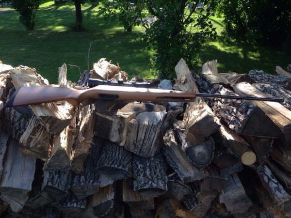

    Scope mounted, played around with adjusting i. I know I need to bring the whole thing towards the butt of the gun.

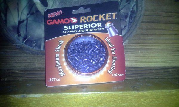

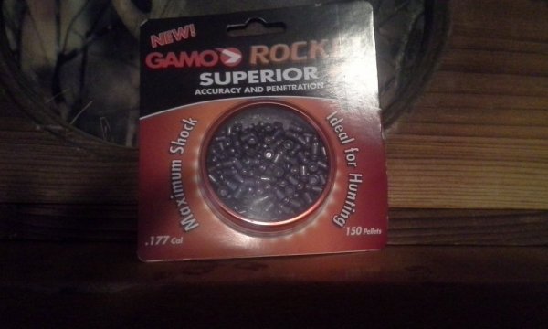

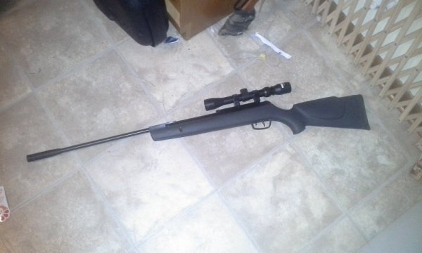

    Here's my gun and pellets I use: PHOTO_20140722_193906.jpg PHOTO_20140722_194039.jpg

    Grizz, from the pic. you're about as far back as your gonna get if you keep the rings in the same location. Loosen and scootch the front ring rearward, then try this-
    With both rings loosened around the scope...
    Close your eyes and shoulder the rifle.
    Open your eyes and see how the scope looks, as far as a full field of view. Don't worry about the reticle being correct yet.
    Move the scope back and forth until you feel good about it.
    Snug down the rings to receiver screws, but don't crank on them.
    Adjust the reticle until it sights right for you, after you open your eyes. (don't get carried away, try to keep the reticle as in-line/vertical to the bore as you can)
    Snug everything down, then walk around while blinking rapidly. clearing your sinuses and shaking your arms. Take a few deep breaths, then..
    Close your eyes, shoulder the rifle, open eyes and if it looks good, tighten everything down. You should be good to go.

    If you're having trouble with the eye relief(needing it further back) you may have to get a different mount - or look into a pistol scope, they provide near unlimited eye relief.
    If you've got the eye relief where it works for you, start by shooting 3 shots from a bench rest the distance you will normally shoot to - lay it on a bag of rabbit food/cat food as you probably already have that around.
    Don't make any adjustments and shoot at the same spot - don't try to compensate for missing.
    After you have a solid 3 shot group start with one adjustment at a time 3 more shots then adjust again, you'll get the hang of it - just remember air rifles are not always really repeatable in terms of accuracy and any breeze will throw them off.

    I think there is quite a bit of room to adjust the eye relief, I set it close to the middle initially since I didn't know where I would want it. Can I use my sawbuck as a bench rest?
