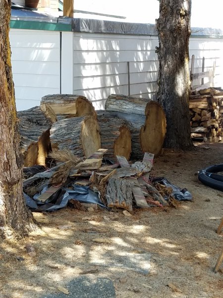

  6. NVhunter
    NVhunter
    Dec 28, 2013
    372
    1,963
    Northern Nevada
    I used Chip Drop for firewood last summer. They delivered the wood rounds within a day but they delivered mostly cottonwood rounds, all which were 3.5 feet in diameter and 25 inches long. I'm still chopping and splitting these rounds which have been dropped over a year ago. Some of the small splits I got out of them I tested with my moisture meter, and it tops out at 50% then flashes "high" after its above that.... Well the splits from the chip drop a year later from the cottonwood is still above 50%... so if your in a hurry for dry wood, I'd pass up on Chip Drop. I don't think you can ask for specific types of wood either...
    My Ideal Steel will burn anything but it's a fight with wood less seasoned that's for sure.
    Good luck and you're getting a great stove.

  8. mrfancyplants
    mrfancyplants
    Mar 21, 2019
    937
    5,172
    South Carolina
    You may be right as i’ve Only used chipdrop for chips so far, however there is a place for comments where you could say: “pine or cedar only please.”
    I don’t know for a fact that they will honor your request. But, the company I worked with was pretty careful that they could actually deliver to my location. I would think they would have moved on to the next drop location if the instructions didn’t line up with what they had.
    I’m half tempted to request a a load of locust. It would likely never get filled, but a boy can dream, right?

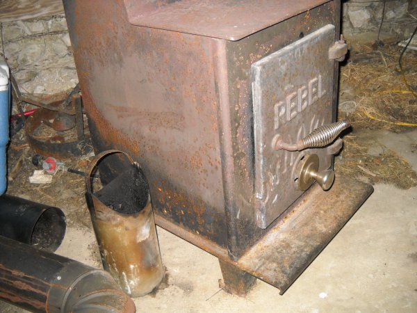

  15. Marshel54
    Marshel54
    Oct 24, 2016
    1,667
    12,942
    The AS would be the 8 cylinder and the Rebel the 6. Rebel wasn't that big. Couldn't find max BTU on it. It is old.
