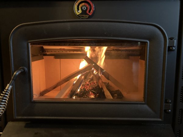

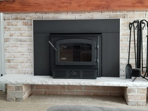

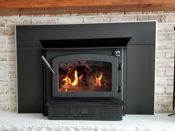

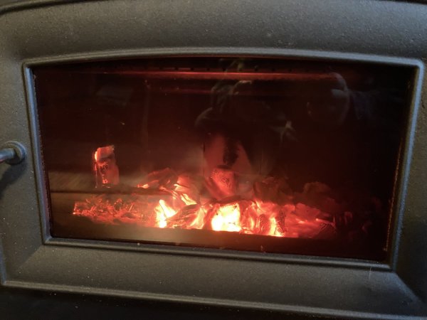

  6. The Wood Wolverine
    18,965
    122,394

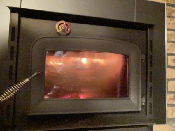

    Got the insert installed today. Not difficult at all. Dad stuffed the fireblock insulation up in and around the liner at the base and some around the top. Started small paper fire first and everything looked good, so we went ahead with a wood fire. A bunch of pine kindling and then two small piece of mulberry. I brought him a big arm full to burn. All seems well.

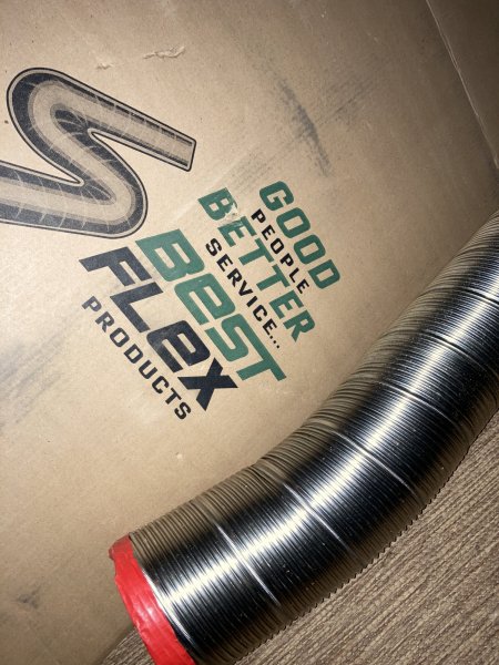

    Looks good. What did you end up doing with the liner?
    Horkn, Eric VW, Chvymn99 and 3 others like this.
  8. The Wood Wolverine
    18,965
    122,394
    5.5” stainless flex pipe.
    Can anyone advise on thermometer location to gauge burn temps? We have it here but I’m skeptical.
    If I put it in the middle, the blower outlet will be going over it.
    Air intake is set at minimum and stove is cruising right above 500 at that spot. Should I get something to connect to the liner a few inches up from stove connection?
    Horkn, Eric VW, Chvymn99 and 2 others like this.

    Nice. I went 5.5 too some could insulate. Sorry I’m no help on the thermometer, I’ve never had one on my insert. Thought about it once but never did get one.
  10. Chvymn99
    21,591
    114,893
    Looks nice. Nice job!:handshake:

    With an insert, that's about what you can do for thermometer placement.
    Looks nice, looks like it is choochin' nicely.

  13. Locust Post
    8,964
    52,619
    Looks nice

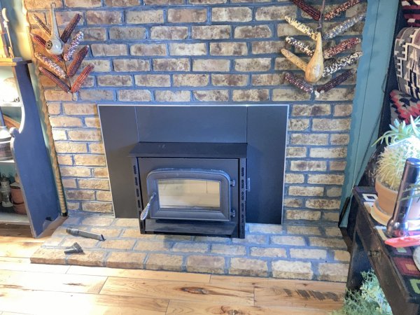

  15. ReelFaster
    ReelFaster
    Dec 1, 2016
    2,887
    20,052
    S.Jersey
    Looks great, nice job! Reminds me of when I did my insert install...........It was a really fun project
    My insert don't stick out very far this is where I keep my thermometer
