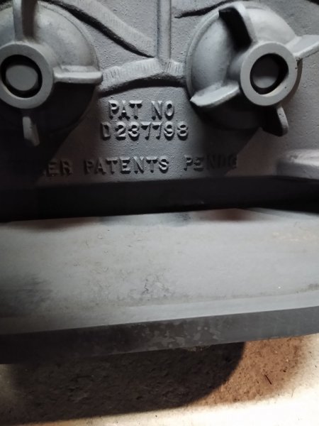

    DA83A21D-14EA-4374-8803-570754776643.jpeg E364A95D-720D-43D8-9153-1B39A8DA0081.jpeg 7AA8D7D6-F8F5-456C-B240-ECE9818A125B.jpeg Pictures

    82E96D02-48D7-48F9-9232-8E681DF5277A.jpeg Front view

    Your stove was made between 1977 and 1980 by the Dunn Brothers fabricators. Probably '77 due to the short handle with stainless spring and 4 fin EZ Spin air dampers. Later models would have a longer handle, a plated course wound spring and 5 fin air dampers.

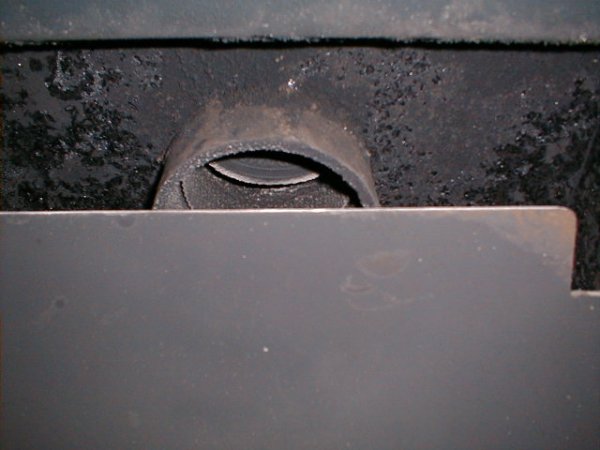

    Thanks for the info. So the back of the baffle will rest on the back brick retainer? There are 4 pieces in the back. 3 low and 1 high next to the exhaust flue. Is the bottom piece on the back wall the location for the baffle to rest? (Picture #2). Or are they the 2 on the sides of the stoves in the back. (location for the back of the baffle to rest) Sorry for the questions but I am one of those measure 3 times and cut once people

    picture 1
    Picture 2.
    I found these 2 pictures. I am confused as to which to copy to my baffle set up.
    Any information for improvements is appreciated.
    We are headed to the farm to look for scrap metal today. Thanks

    Not all stoves will have the small baffle type shelf under the flue outlet. There are side and top vent models and some will rust off. In those cases, rest the baffle on rear brick retainers.
    In 1977 there was a drawing revision sent to fabricators for an optional upper firebrick row like yours has. They may or may not be in the way. Firebrick cut easily if you have to notch them. Just score with a masonry blade and they break cleanly. You should be able to make a wedge shape with a brick to rest the plate on top of the upper bricks. Sliding the wedge forward and back lowers and raises the baffle plate to adjust for chimney draft.
    The second picture was when I was experimenting with baffle height. I then welded angle iron to the plate to prevent the side bricks from crashing inward. That stove is now connected to another chimney, so I'm glad I didn't weld any angle to the stove to allow for adjustment.
    If you make a 2 inch notch in the front corners of baffle plate, it will prevent stagnation in the front and rear corners of stove heating the stove top more equally.
