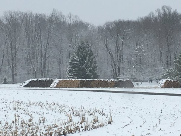

    T post spread on me and freeze and thaw cycles compromise my limited cribbing skills. I just taper the stacks and reuse the pallets.

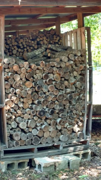

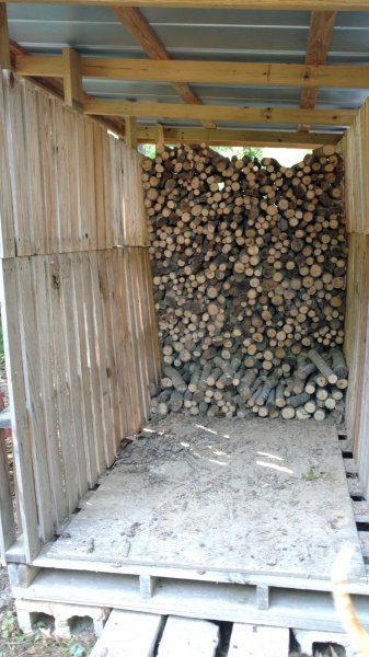

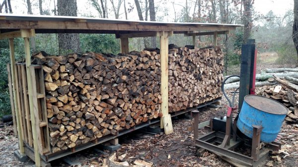

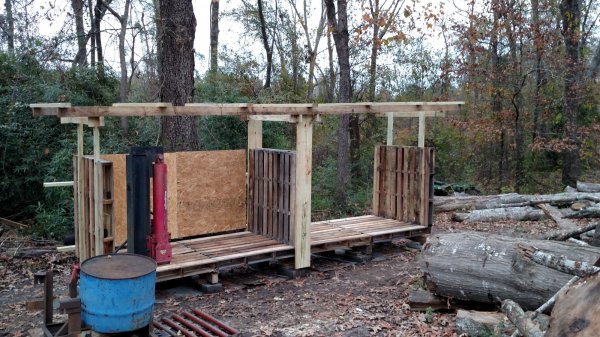

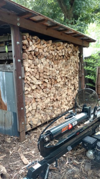

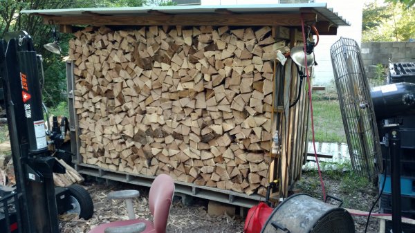

    Here are a few of our sheds.... IMG_20151203_162439323.jpg Built this 2 cord shed with 8- 50x50 pallets, 3x4 runners under pallets, 2x6 uptight supports, 2x4 cross pieces in Dec '15. IMG_20151229_143613007.jpg Got it full with the roof on. Stack is 54x52x94...

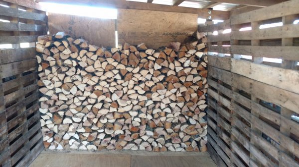

    IMG_20190318_120444405.jpg this is our big shed, 7'wX 6.5'hX14'l...it holds 5 cords. Pallet with scrap plywood on floor. IMG_20190619_110234825.jpg IMG_20190619_110215600.jpg both ends of the big shed...

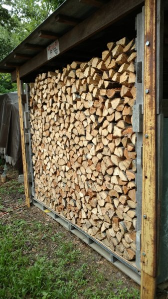

    IMG_20190628_190428767.jpg Good view of a single shed...4- 50x50 pallets, 6' wide roof. Holds 1.25 cords stacked full.
    IMG_20190701_103639985_HDR.jpg IMG_20190701_103752327.jpg This shed is 5x10'. Floor was a equipment pallet, Sides are one row of 48x48 pallets and top row is pallets cut in half...
    I hope these last a long time.

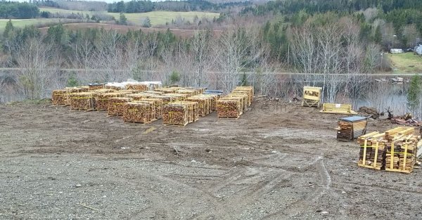

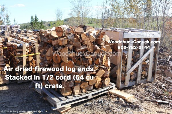

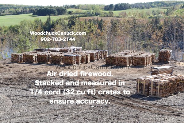

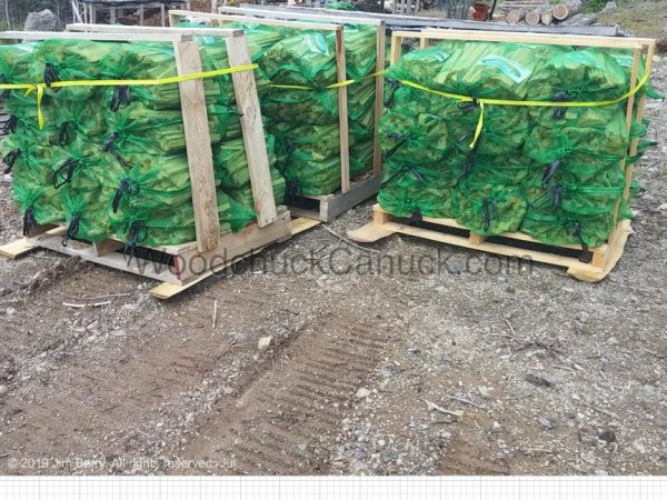

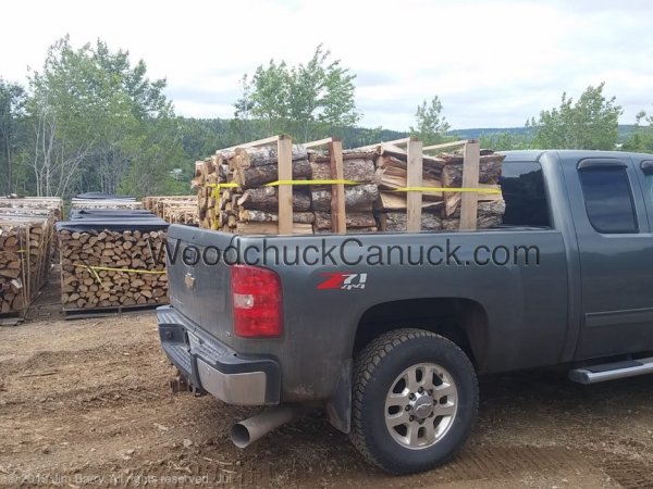

    This is what I'm doing.
    Two pieces of rebar mesh easily bend and connect together to make a 1/2 cord crate.
    Or use some spare boards to make crates.
