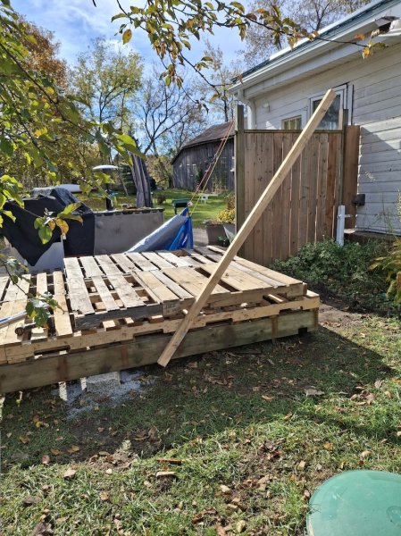

    Lugging the floor deck into place. Bit of a struggle, I'm 5' 4" and a walloping 154 lbs.
    SimonHS and buZZsaw BRAD like this.

    At the tipping point:

    Made it. In place and locked down:
    SimonHS, buZZsaw BRAD and ole like this.
