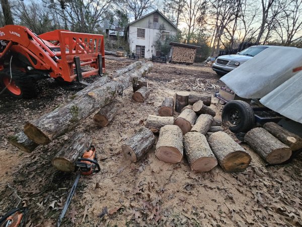

    You have forks for lifting rounds and cutting off the ground...one reason we drilled a small hole in each fork...3/4 bolt with welded washer, holds logs while cutting 20260211_182110.jpg
    It's centered about 2 1/2" back, only prying I'm gonna do is getting logs from a pile.

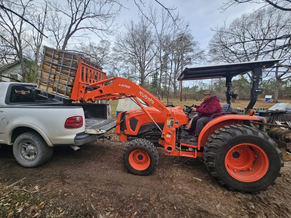

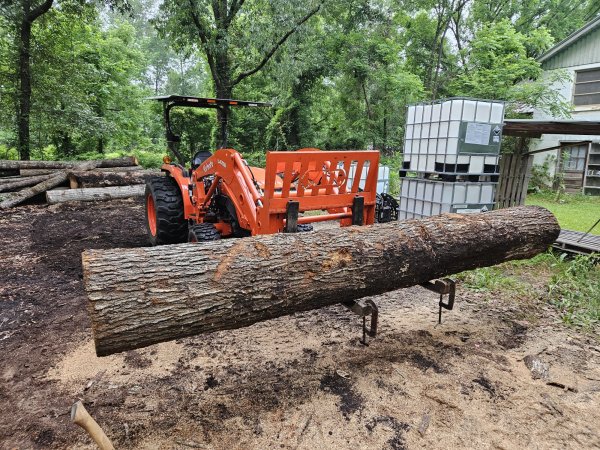

    If you don't want to drill the holes, we did use 4x4 blocks and C-clamps... 20250508_083934.jpg

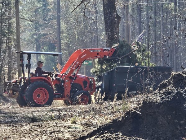

    We bought the MTL grapple, fork style when we had the L3130. It works really good for moving big piles of brush 20260203_110829.jpg

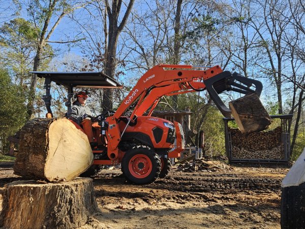

    Or picking up/placing rounds 20260206_094944.jpg

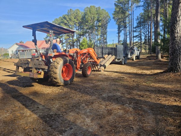

    Or grabbing/pushing the ends of logs 20251126_100335.jpg

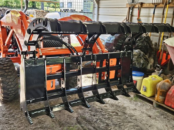

    After we got the L4802, we were blessed to be able to get another grapple. Researched several brands, came down to Homestead and Catawba. Homestead made in NY, Catawba made in NC. In fact not to far from where EA Attachments is. If I was a betting man, Catawba builds EA grapples. They have been in business a long time.

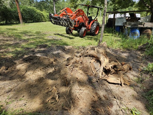

    The Catawba is my choice if we're cleaning up land, the toothed plates between rippers grab very small brush or trees, pinky size or so, and pluck them out of the ground.
    It's not a sissy either, weighs 350# and will rip roots just fine...pecan root 20250419_102022.jpg

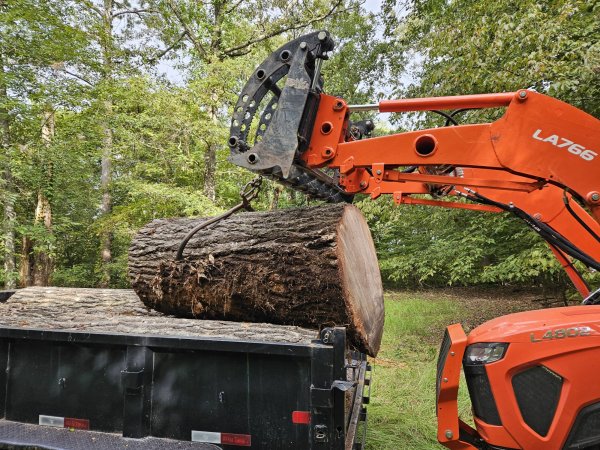

    Oh, almost forgot, we had 2 hooks welded on each grapple, for chain and tong work, sometimes a piece is to big for the grapple... 20250908_095930.jpg
