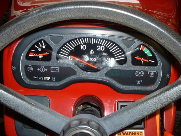

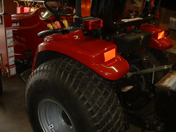

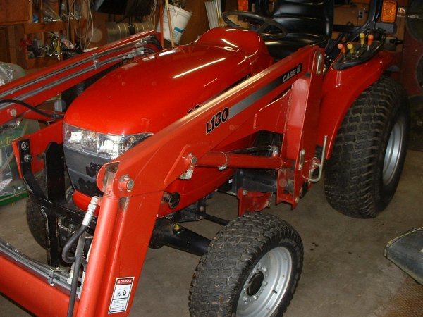

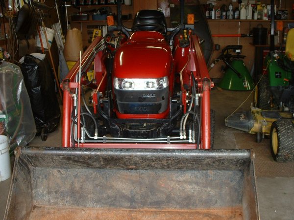

    Here is the tale of my error(s) with forks.
    My Case IH DX33 came with a pin on bucket. I bought a make and model specfic quick attach bracket. OK, so far.
    Then the bucket had have the 4 -24" brackets air arc gouged off to weld on the quick attach plate for the above bracket. Still OK?
    The plates for the conversion were build for light duty, medium duty and heavy duty. Of course they all have different weights. I bought the middle of the road one. (now I didn't research what would be best considering the lifting capacity of the tractor, the choice was still probably OK, but might have gotten by with the light duty?)
    Then I bought the forks, which were of course heavy duty because that is what men do. No consideration of the weight lifting capacity.:picard::picard::picard::picard:
    The end result is I probably lost at least 100# maybe 150#s of lift capacity due to the weight of the plate and forks.
    I am beyond pleased finding a mint 2002 mint PRE EMISSION DIESEL with 398 hours on it. DSCF0003.JPG DSCF0004.JPG DSCF0005.JPG DSCF0006.JPG

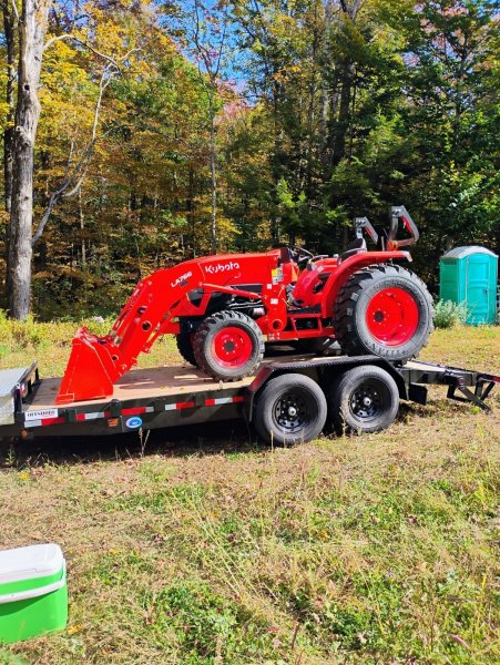

    Keep in mind guy's, I live on about a 1/4 acre lot! I am not out in the woods, I get logs and wood, "Mostly" delivered to the street in front of my home. I am just trying to save my back, (what I have left) from lifting $#!T that weighed 200lb+ up onto the splitter. I am not in anyone of you guy's leagues, Not even close... I wish It was, and my tractor was bought to work my land in New Hampshire but that isn't happening soon. If this tractor can't do what I need, then I should have bought the BIG yellow one! o_O
