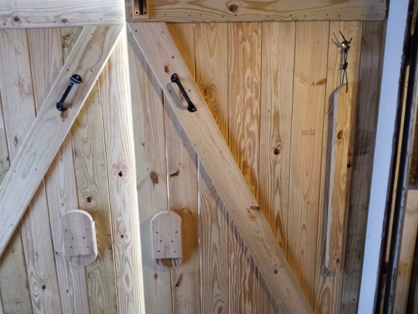

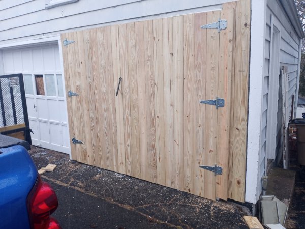

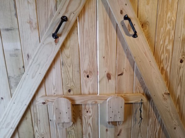

    Well, D-day (door day) came a week ago when an acquaintance reshaped the bottom panel. I remembered this thread and figured I should post our results.
    I picked up a couple dozen 1x6x8 PT decking and some hinges, a couple deadbolts and a bunch of lag screws.
    One door is wider than the other, to allow toys out without opening both. They swing out, leaving interior space to be used. Doors went on last week, finished securing them today.
    A week ago with metal attached to a wire and secured inside..
    Put the bar inside today. The black handles are from the old door, brushed and painted.
    The bar hangs on a peg so it doesn't get lost.
    I've still got to add another deadbolt to the left door top.
    I also will add eye bolts and rope or something so the doors don't swing all the way open and wrap around the garage. A piece of rebar with a pointy end might work in the pavement.

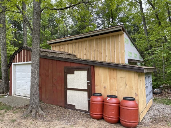

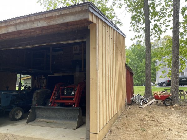

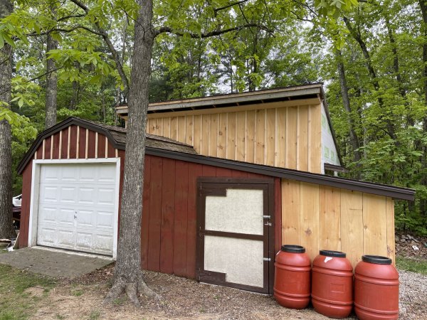

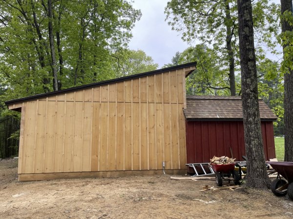

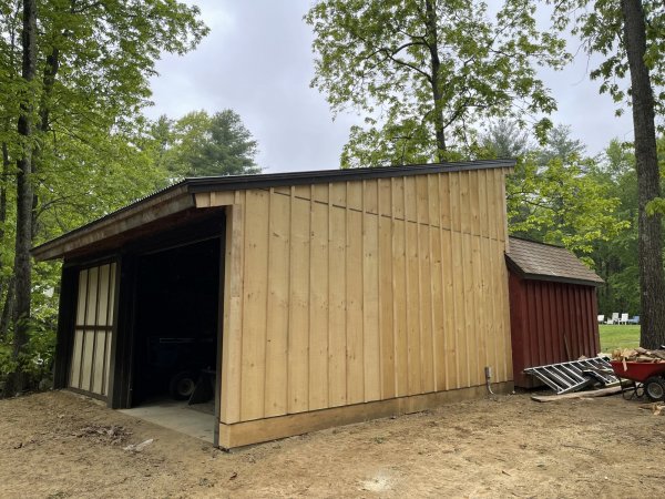

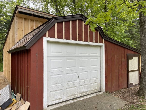

    Some updates on the pallet building. Originally I was going to use red vinyl siding. Since I now have a sawmill, I decided to do 1” Pine Board and Batten instead. Once the boards are dry, they'll be painted barn red and all the doors are getting painted dark brown. Freeze boards will get wrapped in brown aluminum.

  12. T.Jeff Veal
    29,804
    191,492
    That looks great, Case.

  15. brenndatomu
    25,312
    164,790
    Looks great...hopefully you don't have the same issues my inlaws had with the pine siding they did on their house...the woodpeckers and wood boring bees are tearing the place apart!

  19. sirbuildalot
    sirbuildalot
    Nov 22, 2019
    3,425
    22,830
    Mass
    I did have a woodpecker attack the old siding. He disappeared...
    There's about 9 square of siding on the building. Just the siding would be about 3k. Add the J-trim, corners, starter strip, soffits, nails, etc, you're talking closer to 4k I'd guess.
    Got's to save where's I can man :thumbs:
