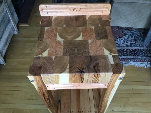

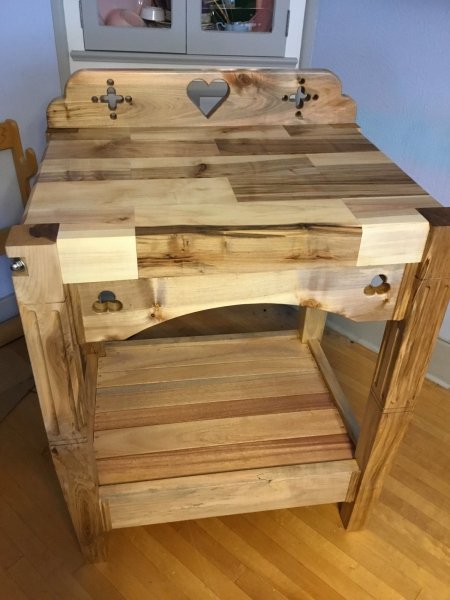

    It seems that I’m also always looking for pallet wood ideas too. Here are a couple of red maple/oak standing butcher blocks. 7FC445FB-5F17-4267-B25B-C1D7C8B3466E.jpeg 34F8405C-ECEB-4C87-99E8-E03F50250C71.jpeg
