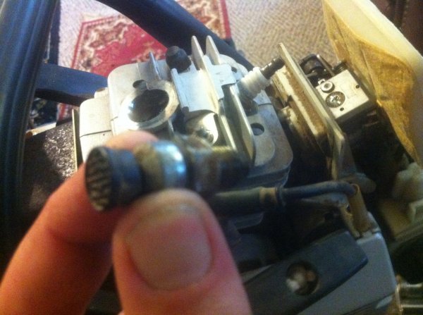

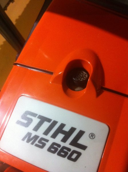

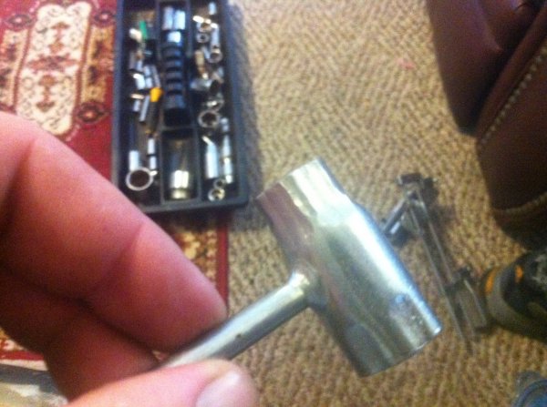

    Put a few new filters in the saws this morning, and robbed the decomp out of the 036 to use in the 660. I have one on order from the dealer but it won't be in till next week, and I wanted to play. :)
    This stubby scrench made a convenient tool for the job (thanks Dex!) I would have needed to remove the handle to use my deep well socket. Just needed to round the corners a bit in the bench grinder.

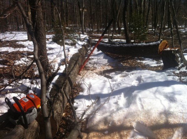

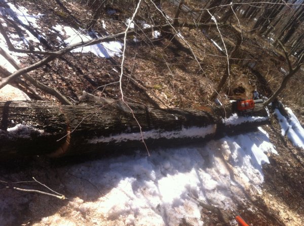

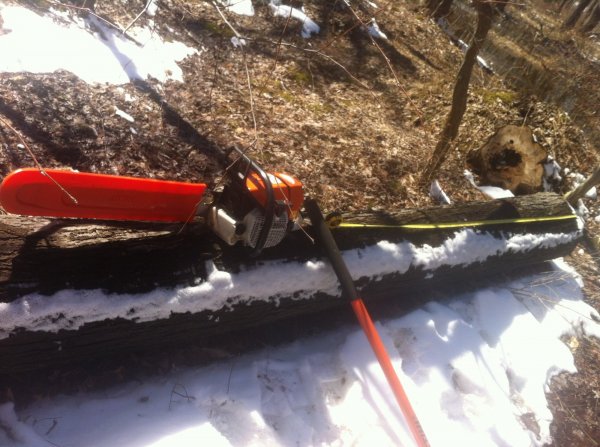

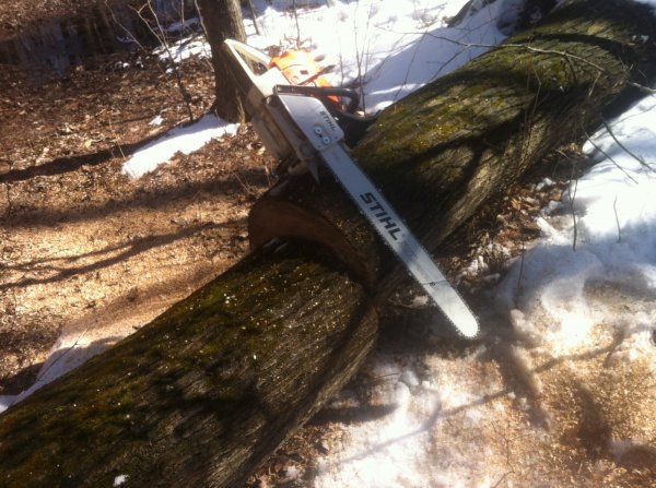

    Took her for a spin on a couple nice maple logs that I'll be milling soon. Hot knife meet butter! :dex:

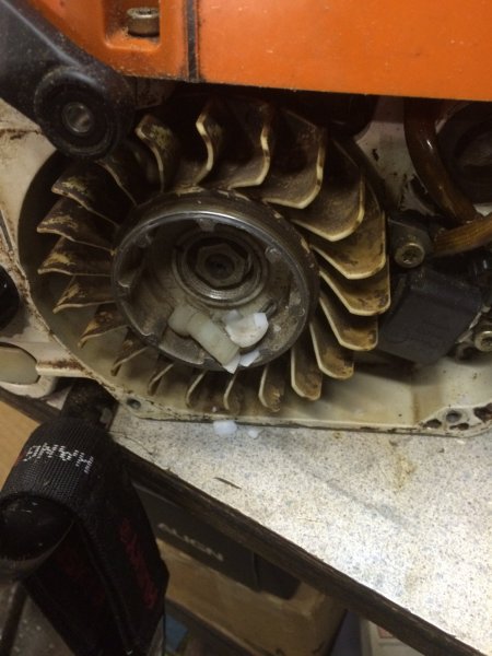

    My Tennessee-an 066 is heading right for that handle ...................

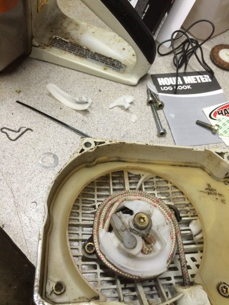

    Oh just wait to a metal foreign object gets into that poly flywheel when your buzzing 15K plus in cant testing. If yours can do that without burning up.
    Instant lightened flywheel. :rofl: :lol:

    By the way I just had a guy bring in a stock 036 that did the same thing as your pics.

    Did that happen right after getting it back from Tenn.? I traded with a member on here for a flat top 066 and the pawls disintegrated on the second or third pull after getting it. He was kind enough to offer to pay for new pawls but how should he have known that was going to happen? I have wondered if something happened in shipping.

    They just give up sometimes.
    The 066/660 has about 210 psi when I get done with it. That will kill starters.......but not much sooner than a stock saw.

    I blame age of parts. The guy had bought the 036 new and first time needed replaced.
