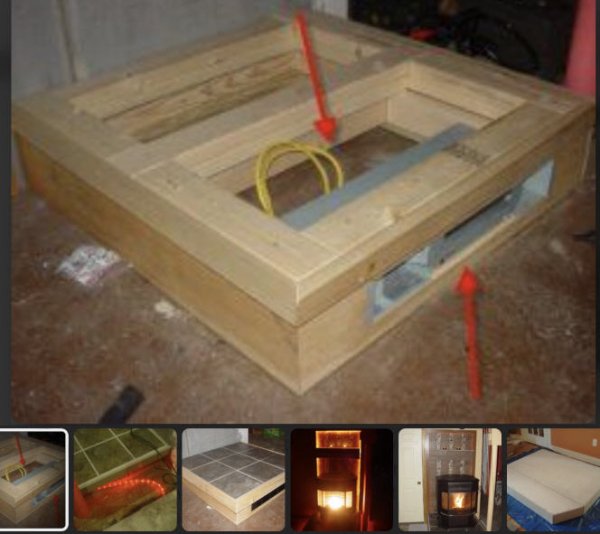

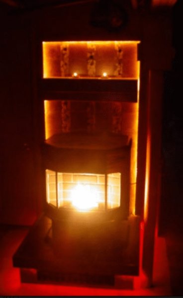

    Hello
    All my stoves in the basement, garage and workshop are on home made raised Hearths for 2 reasons.
    1. The cement gets damp sometimes and the stove will wick up the moisture and the paint will peel off on the bottom portion. Not a big deal but it just stays nicer longer.
    2. They are all raised hearths so people walk into the Hearth before the hot door glass and get burned. Again not a big deal but a nice safety factor around kids.
    Also I installed a 240 VAC 900 watt electric kickspace heater in the hearth pad to keep feet warm when the stove is down for cleaning. :)
    Then for looks I just added a tile mantle with candles and some colorful rope lights. :)
    Note: The stove in the pic below was my old Avalon Astoria that I sold.
    I now have a Harman P61a with extension hopper that holds 100 lbs of pellets in it’s place. :)
    Click on pic to enlarge
