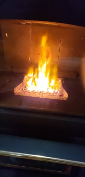

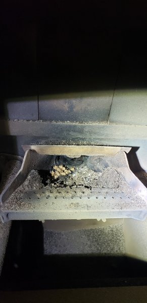

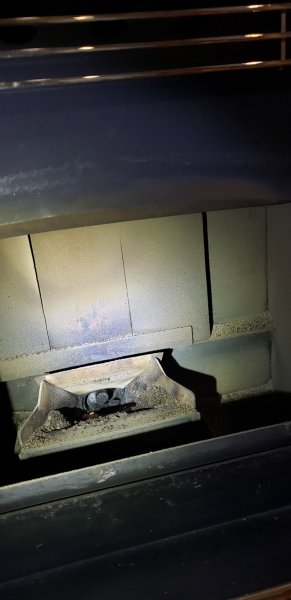

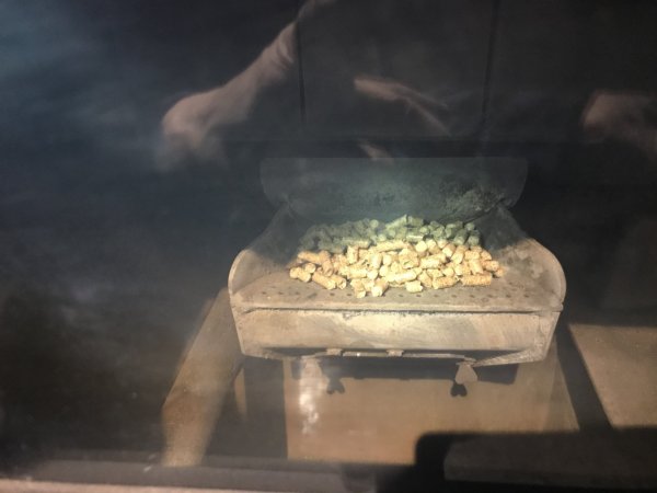

    Hi all and thanks for adding me to your group. I have an older P61-2 that I picked up in the spring for a decent price . I didn't really use it until this fall and it seemed to run ok. I'm pretty new to the Harman world but not to pellet stoves, my other stove is a Lopi Pioneer Bay that I've had for 6-7 years now and that thing just keeps going and going .

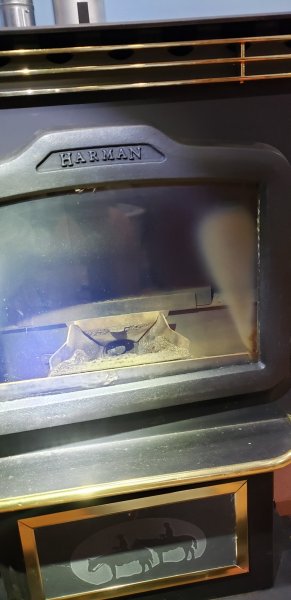

    On to this harman, when I go to light it with the ignitor it's hit or miss, more miss now than anything . It also seems to burn dirty as in black soot, not real bad though. As far as the installation goes I installed the stove myself It's in the basement and I'm running 4" duravent and according to the math it is within draft requirements I don't have the figures on hand but it's right I'm also running a 3" outside air kit. Now here's the funny thing, I tested the draft and on high blower it's 82 and on low blower its 55 and that's with the adjustment on the board turned all the way down

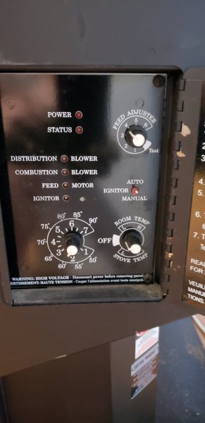

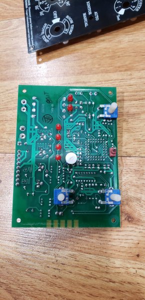

    So I know it's getting plenty of air movement and the ignitor gets hot but now the pot fills up to overflowing and sometimes it starts and sometimes it doesn't. Seems this is a really old board also and it has the black esp. If it needs a board which one should I be getting as the one in there now doesn't have a service port or a dip switch I don't mind replacing the esp as the one in there now was put in in 2003 and is there anything else that needs consideration
    Overall when the stove is running it runs well right now I'm running it in stove mode between 2 and 3 as it hasn't been really cold yet

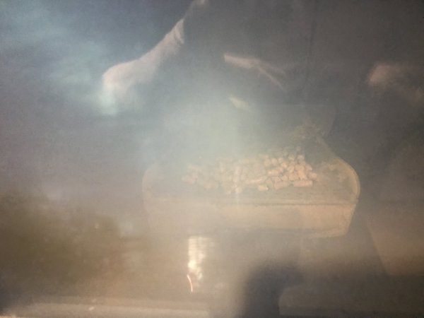

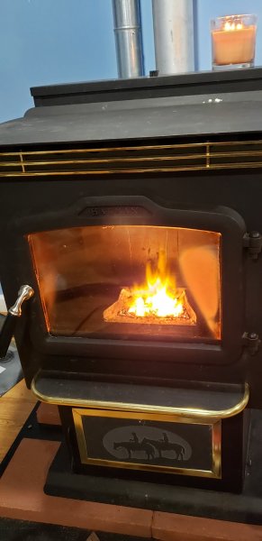

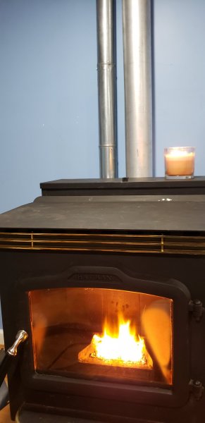

    Couple of other pics, sorry if they are so big trying to do this from my phone

    Is the area under the burn pot clean?
  5. tazz
    tazz
    Dec 29, 2019
    31
    132
    Western MA
    Oh yeah, everything is very clean, have had the ignitor out several times to make sure there's no build up. The stove doesn't even have a ton through it yet

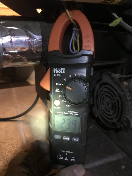

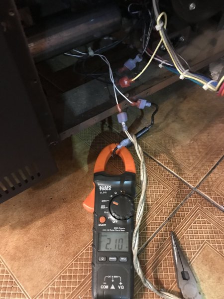

    If the wood pellets are good and dry, Then it Sounds like the triacs on the circuit board are weak and the igniter is not getting enough juice.
    Can you put a current clamp on amp meter on the yellow wire in the back of the stove that goes to the igniter and see what it reads?
    The pic below shows 2.1 amps for a good working 300 watt igniter in a Napoleon Insert. Model NPI-45

    We just fired up ours for the evening.
    I get 2.39 amps, I do not have any test connections to read the voltage but it should be approximately 120 VAC and 306 watts and 50 ohms running super dry Vermont wood pellets
    Ours fired right up.
    What do you read for amps?

    Ok, let us know what you read, it will be good to compare measurements. :)
    E=IR
    So in my case
    2.39 x 50 = 119.5 volts
    My guess is:
    If your igniter triac on your Circuit Board is not putting out close to 120 volts then your current reading would be less.

    The dip switch block is between the CB and the mounting / face plate. In my stove, you actually have to remove the CB from the face plate to see and access the dip switches. I'd be curious to see how the startup sequence switches are set (first three switches) - default of modified setting.

    Suspect this is a long shot, but have you confirmed the burn pot surface is extremely clean with no cookie or carbon buildup in there? Also the two air holes just beneath the flame guide, and all rows of the burn pot holes are completely clear (make sure you can push a little drill bit into each of them)?

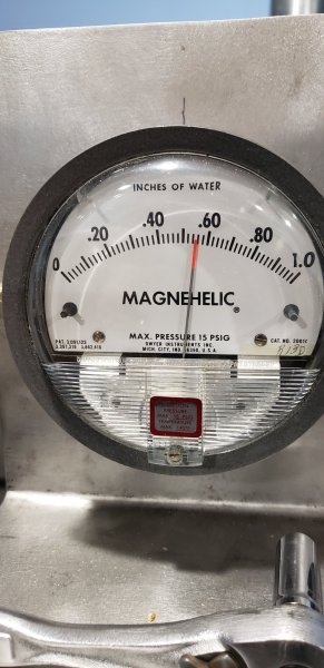

    When the stove initially tries to start up, what is in the burn pot? What I mean by that is, when you clean it - do you clean so there is absolutely nothing in the base of the pot, or is there generally a bit of ash and charred pellets left from the last burn? Having some leftover ash and charred pellets from the last burn definitely helps the stove to light more quickly on the next startup attempt.

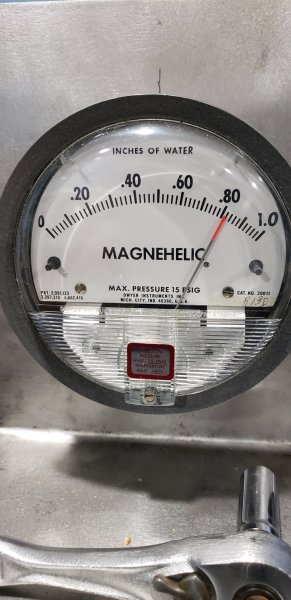

    Your draft readings are pretty high. The normal high draft is -.5 to -.6 and low draft is -.35 to -.45 - I know you have adjusted the low voltage screw as far down as it will go, so there is little else you can do. I don't know if "too much" draft would cause the issue you are having, or at what point it would cause an issue. I can tell you that replacing the CB with a modern one will give you the adjustment you need to get the draft into the normal range, or at least much closer than you are at now. The newer boards allow for a much broader range of adjustment than the old. I'm not advocating buying a new board, just thinking out loud right now.
    When you say you are getting black soot now, is that on the glass, in the burnpot, or the fine layer of ash on the inside of the stove walls when you shut down for cleaning or what? None of the above?

    Well the board does not have a DIP switch as the pic shows. I also checked the yellow wire (as was suggested) for amps and what I got was 0.09 according to my fluke meter, there was 118 volts there also. I'm betting this board has seen better days. Does the service port on the new boards protrude through the face plate if so I'll have to cut a hole in this one to accommodate it.

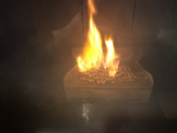

    I know my draft is really high, I didn't think it would be this high. Especially seeing as I have 3 90's and a tee at the stove, that's why I went with 4" just as the manual stated. It's sealed up really good too, I love the Duravent PVP, those silicone seals it comes with work awesome.
    As for the ash being black, it's more dark gray, I think it's just the way the pellets are this year, my other stove looks the same so I'm not going to worry about it. The glass is staying pretty clean too, what you see in the pic for the glass is 4 bags worth. What you see in the stove is one bags worth seeing as I shut it down this morning to test that ignitor circuit and yes everything is way clean when I cleaned it yesterday, getting all that carbon ridge out of the burn pot is a pia. I know that it starts better with some build up also but I think my test results are pointing me to a new board.

    Hey Tazz....really stupid question from my observation, but aren't the DIP switches on the back side of the board? (next to the transformer)
