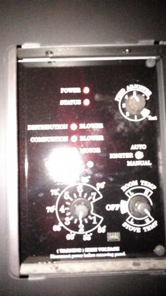

    Ok, NON scientific test just completed.
    Pellet: Blazers Douglas fir.
    P-43 with add on hopper, Capacity of above pellets, Just over 2 bags. Id guess 85-90 pounds.
    From first turn of Knob, fire up, till burn out, 37 hours on setting 2. Picture of all settings on next post.

    Picture of settings for the above test.

    Looking at your settings it looks like the temp dial was at 2. Did your room blower shut down during your test? I ask because my experience has been that it shuts off unless it is set at least a little over 5. If it does shut off, then a lot of heat goes out the pipe. Maybe your stove acts differently than mine do though.

    Looking at the pic I can't tell if it's manual or auto, blower will only shut down if it's in manual mode if set at less than 5

    Oh, I was confused - I was thinking that is what it did in stove temp mode, but that is not the case and it only does it in room temp mode. CRS!

    It only does it in Stove Mode. Stove mode manual the dist. blower will not run unless the heat setting is 5 or above. In room temp manual the stove won't shut down.

    Auto mode, fan on High. Ive never used manual, and don't have a Thermometer hooked to it, since its in the basement, and want the heat to travel upstairs into main living area.

    Now I remember why I get confused as to the modes and how they act - I usually only change modes with the P43 and the in-line thermostat messes with how it works. Figured that out when I went to change the settings last night to account for the wind and how it affects the bedrooms (took it off thermostat)

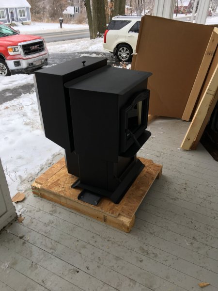

    Fellow Hoarders Slacking ? or have i built such a trust with all of you fine folks that no pictures were required ? Was actually going through my phone and forgotten I had taken this photo Imagine that forgot something theres a shocker DOB forgot something....
