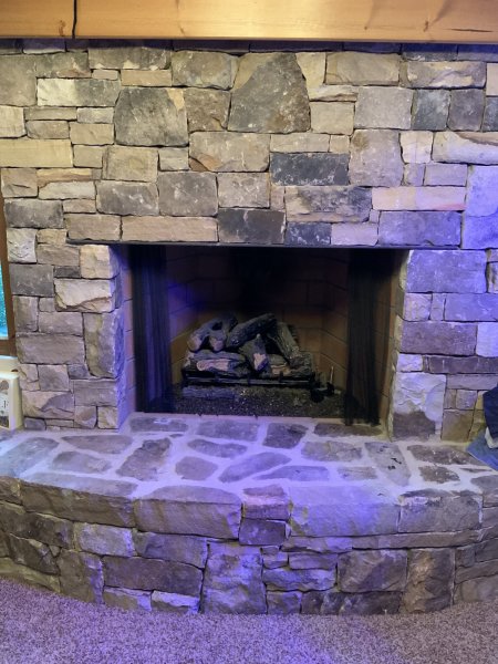

    I do not have room to extend the hearth, as it is raised and would interfere with the room to add to it further. The chimney has some bends in it, so would be hard or impossible to line them anyway, right? It looks like I’m going to have to tear everything apart completely, or give up this dream.
    I would go ahead and order a VF-100, but I don’t have a way to install the chimney easily or cleanly, which is doubly frustrating because I already have these useless chimneys that I can’t use.
    Horkn, eatonpcat and Marvin like this.

    Boy, its amazing how much that looks like a "real" masonry fireplace!
    If you were to put a free standing stove out front, you could maybe extend the existing hearth to set it on...if the fireplace opening is tall enough to accommodate the height of the stove pipe. But putting it on a new "hearth extension" out front (where the carpet is now) would be more likely...but if that encroaches on the room too much, then yeah, on to place C or D.
    How tight are the bends in the chimney? If they are 30* or even 45* (should never be more than that!) you should be able to get a 6" liner in it since it is 12" ID...and most stoves only use 6" now. A 6" liner with 1/2" insulation blanket (highly recommended!) would be about 7.25" to 7.5" OD total.

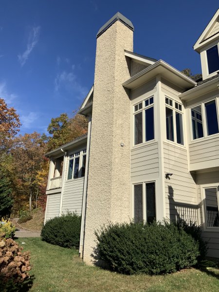

    What does the fireplace/chimney chase look like from the outside? I assume the FP has a "bump out"...

    The chase for both identical sheet metal prefabs. One on each floor, obviously. Unfortunately, both rooms preclude extending the hearth.

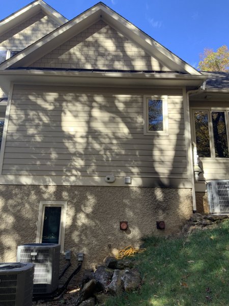

    image.jpg image.jpg Here is my only place to get a chimney out of the unfinished part of the house where I could attempt to install a VF100. I can’t go up through the house anywhere, just limited by the floor plan.
    Thanks for all of the help! I have a call into my chimney sweep to see if he has any ideas also.
    Horkn, brenndatomu and Marvin like this.

    Yeehaw! You aren't kidding about difficult! I wouldn't rule out the possibility of pulling off an install there...just wont be easy...definitely a good job for a pro to look at first hand!
    One other option might...may be...to install a zero clearance high efficiency wood burning fireplace in place of the prefabs...could possibility limit the amount of demolition and new construction that needs to be done...a stove/hearth shop could tell you more about that option than I can though...

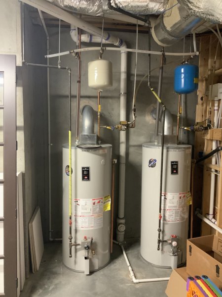

    brenndatomu RGrant I got the rough estimate from the chimney sweep, and will have an itemized quote for a zero clearance fireplace in place of the lower prefab. It will be about $15k with Class A and a bit less with air cooled pipe. That's a whole lot of years worth of heat to pay back out. If the real, binding estimate comes in any differently I will update the thread.
    He did say he can install a 6" Class A chimney out of my basement, to the right of that small window above the vents, for about $3k. There is not much room to put a furnace down there as you have seen, and I need to consult with an HVAC contractor for the cost to run all of the ductwork.

    Don't go air cooled...it doesn't stay as warm as class A doublewall...which means more soot/creosote buildup. Surprisingly, this is a case of 2 walls are better than 3.
    If you go the furnace route, $3k chimney, $6k (+) furnace (w/ tax n shipping), And I would guess at least $2k for ductwork...
