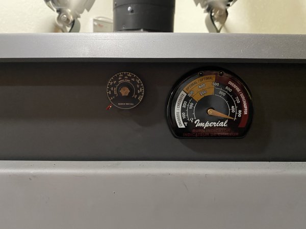

  19. Wade
    Wade
    Jan 29, 2019
    42
    198
    Missouri
    Interesting burn temps, I am slightly astonished, especially with you having a damper on chimney pipe. If I had temps on the stove pipe and just to the front right of cat probe that you have, I would be cooling the stove down. But I have 8’ of single wall and another 18’ of triple wall insulated through second floor and above roof. Massive draw. The way I do cooling may seem contrary but I open air all the way, disengage cat, then crack the door, and the rush of cool air drops my single wall pipe temp from 450 back down to my preferred range of 300-350, then I reset cat,
    My long term running settings is 1-2 tiny notches of air, cat activated, stove pipe temp of 300-350, stove top of 400-500 and the area just to right of probe hole cruises in the 550-600 range. This has me with a black box and occasional secondaries, and I do get a bit of window black in corners after a few days, but easily cleaned off. Usually will heat for 8 hours+ Good heat and coals for longer.
    My highest spot just right of probe ever was 675-725 once.
    I use an IR gun and a stove pipe magnetic probe. Pics to show temp gauge location, but usually use my IR gun.
    CFE2043D-A89D-4942-8122-38CE2528DF23.jpeg 2324AE6C-ABDC-480A-B3C6-E9BBC84A5100.jpeg
