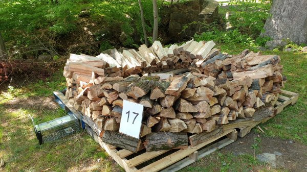

    Kinda surprized that the dark stuff on left that was buried is 16 on outside and only 26 on the split with the meter.
    The stuff thats on top read 8 on outside and 22 on the split.
    So not that great.

    Meh. You still have time before you'll need to burn it. It'll go. Your dog seems happy to tag along for the fun!

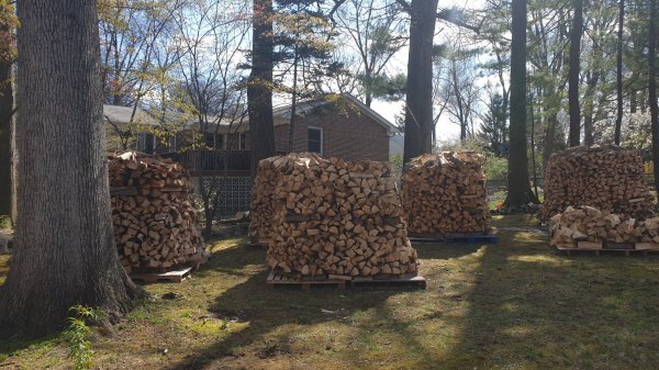

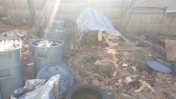

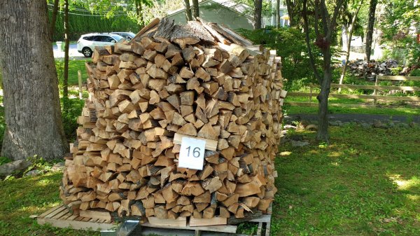

    If you stack it in a holz hausen then you can throw your shorties and uglies right into the center. Save the nice straight pieces for the the circumference of the pile. I don't have a wood shed so I leave all my stacks uncovered unless I plan on burning them *this* winter. Those I will cover with a HarborFreight tarp weighed down by splits with eye hooks screwed into them to hold the tarp in place. I don't cover the sides and as the pile got smaller and smaller from use I had zero problems with wet wood.
    In the first pic you can see the remnants of the pile I burned last winter. I burned all the dry wood I had. Since October of 2019 I've been chopping tree service wood 90% by hand. The crotches and the knotties I use my 34-ton Champion log splitter and/or a sledge/wedge combo.
    Each stack has 4 pallets underneath and are 8' in diameter and about 7' tall at the apex. Roughly 2.25 cord per stack but that includes shorties and uglies. For the tops I chip away larger rounds with nice bark all the way around to get my shingle pieces. Way more stable than traditional rows and since they are 7' tall they take up less room and look amazing.
    Unfortunately for me the neighbor behind me thinks they are an "eyesore" and called me a "dirtbag" for living like this. They also said my kids live in a "hillbilly loser house" because of the wood. They've called the building department on me (the code enforcement officer turned out to be a wood nut and he loved everything I was doing) and the only "violation" I had was that I had an IBC tote of kindling too close to the house. That took all of 10 minutes to move 6' away.

    Looks great! :yes: Too bad your neighbor is an azzhole. :whistle:

    Wow, just wow. They say "it takes all kinds," but sometimes I think we can do fine without a few kinds. Don't let the jerk get you down, I'd be proud to have your woodstacks.
