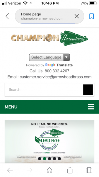

    We made some progress. It is an Arrowhead, which my husband found out by doing a Google picture search. The oval knob was the giveaway. So, we need to get a replacement stem. They come in different lengths, so we will need to take the old one out and measure it. There's a YouTube video of how to do it.

    Anyways...here is the manual on this spigot (I think) read bottom of page 4...probably the issue Midwinter. Lots of good info in this repair guide!
    http://champion-arrowhead.com/media/wysiwyg/PDFs/Frost-Free_Hydrant_Guide.pdf
