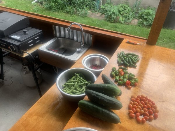

    The sink is together and works great. Not bad for a cut up kitchen sink anyways. I put the drain out the side of the kitchen area and it dumps the gray water alongside the rain gutter. The link below is the short video of it functioning. I plugged it and let it set for a good half hour and didn’t find any leaks!! A little surprising honestly.

    The sink works so well We decided to put a water filter in-line under the sink so it’s safe to drink and use for cleaning. I don’t remember exactly when I put the hose in the ground but I’m guessing 10 years ago…. It’s a super heavy duty EXPENSIVE garden hose that is still fully functional today but I don’t trust it for cleanliness at all…

    Just got the filter installed and it works and tastes great no leaks. :dex:

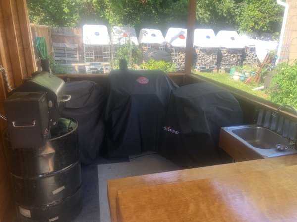

    the black-stone has been left on the porch but I decided to see if it would fit in the kitchen and to my surprise it fits great next to the sink! No issue at all… there’s a lot of room in there still more than it looks like actually. The covers make it look much tighter than it really is in the kitchen area. I just need to locate and procure one more propane tank and it’s all set to go.

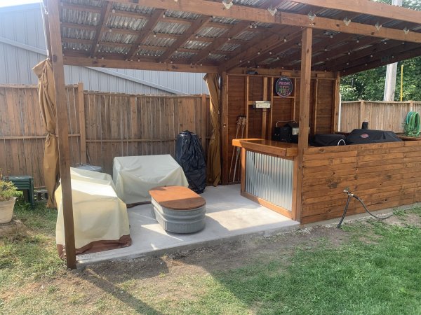

    I would like a vent fan at some point but so far I haven't really needed it. It be really nice in the winter when the bar is closed in with canvas and I’m grilling or smoking things so there’s an easy avenue to direct smoke out..
    The seating area will get a ceiling fan at some point although it won’t be till next year most likely. We still need to run power to the locations we’d like there to be receptacles and the fan. As of right now there’s one receptacle hooked up but that’s enough to run the smoker, lights and food warmer which is all we really need for the moment. If I stumble on an EMT sale anywhere I might do it this year but chances aren’t very good it will get done.:whistle:

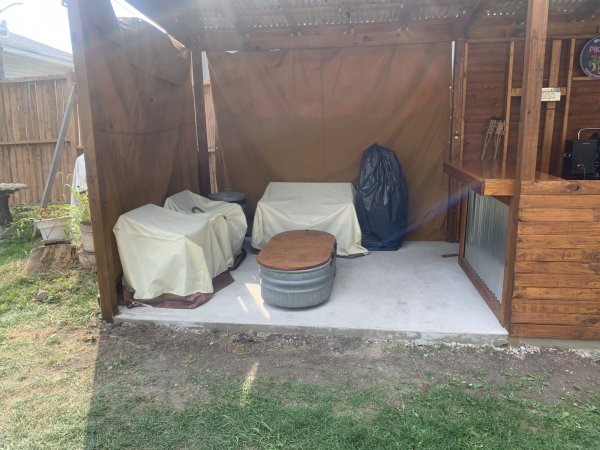

    I did a good amount today and put canvas up on the back and the left side. I modified a canvas to be the right angle on the left by folding it where needed adding grommets to the top. They slide back out of the way and I use a rope to tie them up to the post. When I pull them tight they seal up very nicely right now there loose.
