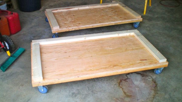

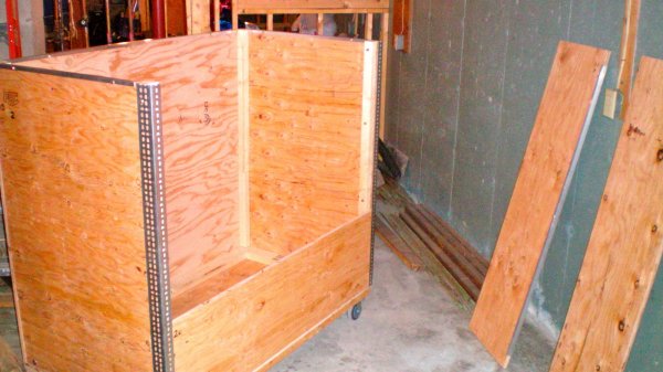

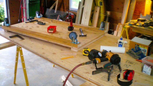

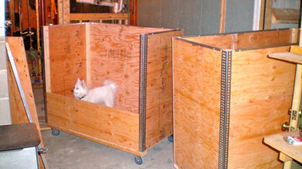

    1st inspection (Giz is a hardazz)
    All 2x4s glued and screwed (box is gonna get slammed by wood). A 2x6 pc was added where the red screw bin is. Also glued.
    The 2 end panels had blocking glued & screwed also. Then all screwed together down in the basement.
    Boxes are 32"w x 48"h x 60"d. 4" HD casters, 2 solid, 2 swivel. Aluminum 3/4" edging. Steel corner angle to slide panels in
