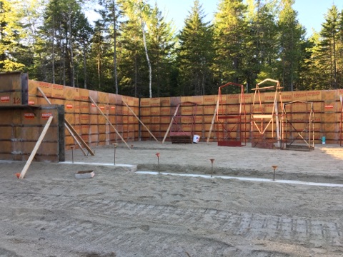

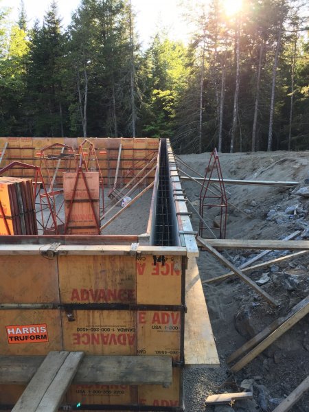

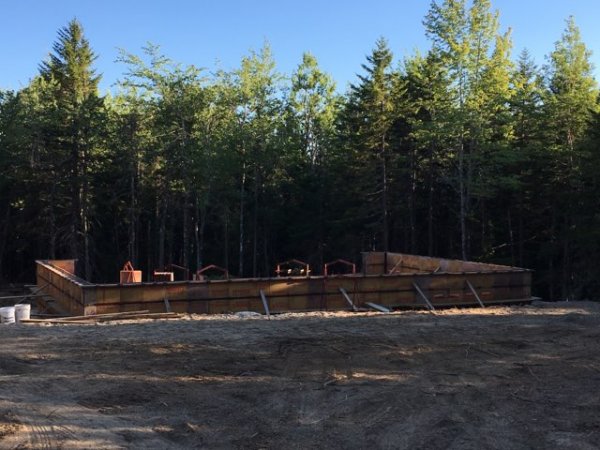

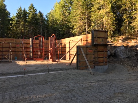

    Forms are up:thumbs:, I think the concrete is coming tomorrow. Full concrete walls on three sides with and 8 foot step down wrap around to the back wall. We will have 32 feet of stick built wall in the back for daylite walk out.
    Perforated pipe drains inside and outside of the foundation are in.
    We have enough pitch and were able to get the septic drain in under the slab, so we made some last minute changes to add some drains in the basement floor for a future bath.

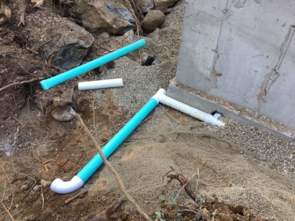

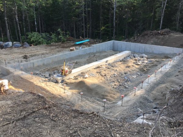

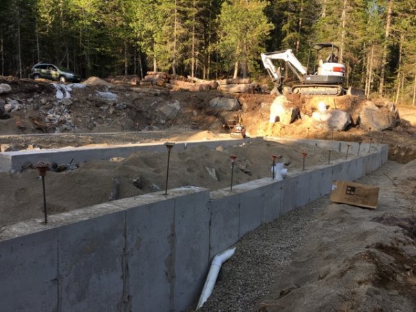

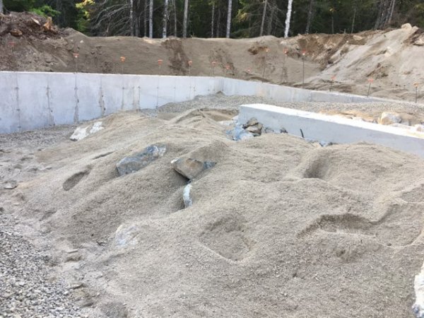

    Forgot some pics.
    Hole for the septic out.
    Gravel over top of the blasted ledge.
    Perimeter drain.

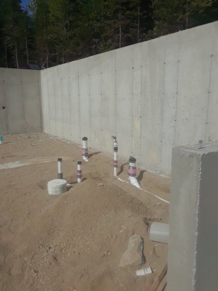

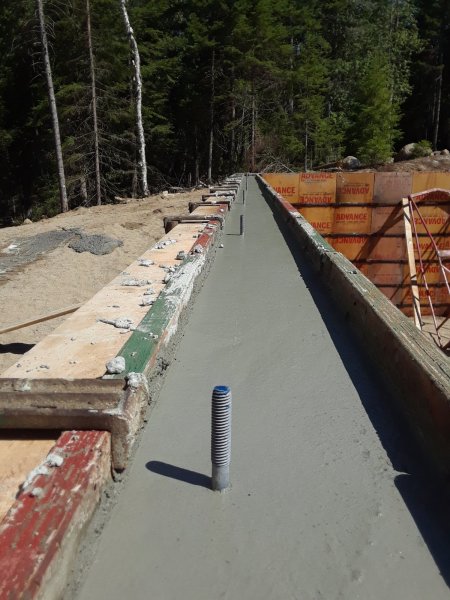

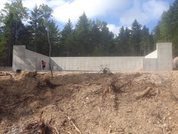

    Walls got poured last week.
    Forms came off and below slab plumbing is in, future basement bath and the main drain line. The slab might get poured this weekend, weather dependent, tentative set date for the modules is 7/31 also weather dependent.
