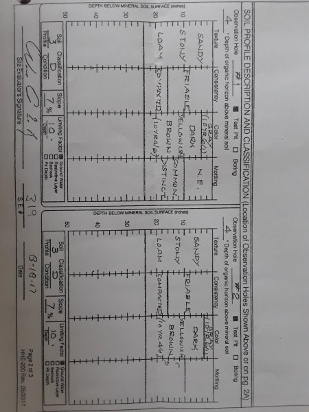

    3,894
    22,936
    You are asking about the existing soil on the site? Where there is any...before you hit ledge it seems to be very sandy...typical spruce/pine forest floor. The soils report for the septic says sandy-stony-loam. The septic is a 1000G tank with a 900sqft pipe and stone disposal bed designed for 270G per day flow. It will be all gravity fed and we think we will have enough drop so that we can put the drain in the basement floor so that we can eventually have a bath or whatever in the basement without having to pump.

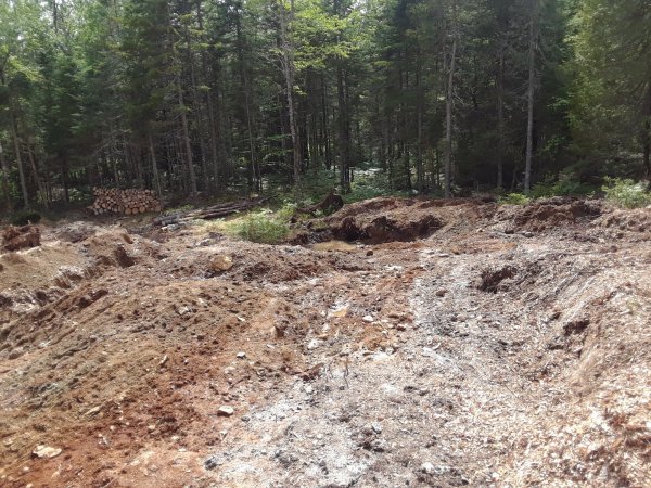

  11. DaveGunter
    DaveGunter
    3,894
    22,936
    Hmmm I'll definitely bring this up cuz that sounds pretty close to the situation. Not sure if you'll be able to see it very well in the pic and the scale is hard to see. The ledge to the right of the pic drops off steep about 3-4 feet down, we are leaving that alone and blasting the ledge In the left of the pic, and then "nestling" the foundation up to the ledge on the right.

  14. basod
    basod
    Nov 4, 2013
    5,048
    20,841
    Mount Cheaha AL
    Sounds like the situation you’ll be in.
    Hopefully as they core through there is void beneath otherwise you’re carving out a swimming pool of stone and from my experience water will want to find an equilibrium which is the basement.
    There appears to be good grade from right to left. Ask them about backfilling with stone and drain tile and ensure waterproof membrane is installed- you get to do this once don’t regret it down the road.
