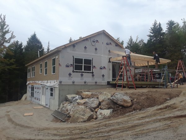

    Power is on, so I finally got a taste of the well water, tasted fine, clear and cold. Sent out for some water tests today.
    Plumbing is all hooked up so we can start painting inside, now that we have a way to clean up and I've got to do a backsplash in the kitchen.
    Porch is happening.

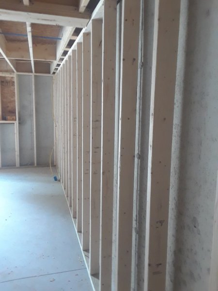

    Framing out walls against the foundation, spaced out a little from the wall so the spray foam can get in behind the stud so there is no thermal break. We are spray foaming the sill as well.

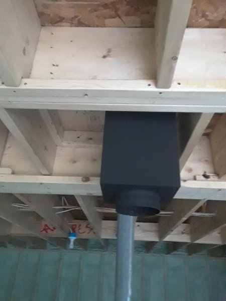

    So the chimney is in and I've got some questions, maybe someone around here can help.
    Class A from the ceiling of the basement inside a 2' x2' chase.
    Here's the connector hanging down in the basement.

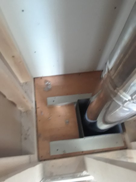

    Looking up where it passes through to the first floor. Notice the gap between the plywood and the square piece that surrounds the pipe?...how do I seal this? Spray foam? Caulk?
    Looking down from the first floor, I'd like to insulate here, what do I use and can I put the insulation right against the square piece?

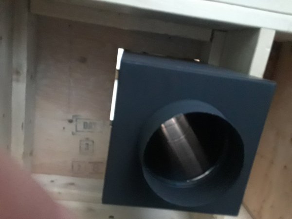

    Here is looking down from the attic. I need to seal this off also...cut a piece of plywood to fill the space?...can the plywood touch the metal? how do I seal it and insulate it?

  17. rottiman
    95,937
    Roxol insulation will work for what your are doing
    papadave, Eric VW, milleo and 7 others like this.
  18. Well Seasoned
    83,790
    1st and most important, the top of that ceiling box needs a storm collar as well as the radiation shield in the attic. This prevents anything falling in over the years or future owners from blowing insulation in for whatever reason and it ignites down inside the ceiling box. (This is code too)
    X2 roxul batts (2x4) with some stringers to hold it in place.
    The crack, we would use a high temp silicone, which is overkill, but that's what's on the van.
    Yes, plywood can be added in the attic. The Radisson shield gives you the 2" clearance.
