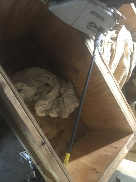

    Here is the measurement stick that Bret Hart built a few years ago. It's off of 18" since that where I cut for my use. It's pretty sweet quick on / off into my pocket to allow me to make the through cut.
    walt - his set is the cats meow... I'll be building one for me when I cut for my Neighbor... it's like they were showing for a walk paint marker. But he ran a all thread and butterflied butted to locked it in. It's marked with several different lengths.

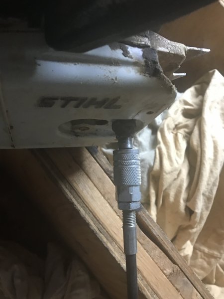

    Oh, that's slick , quick air connector:thumbs:
