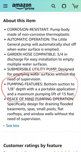

    That burcam pump is a solution for just pumping it out, yep... down to 1/8 inch.
