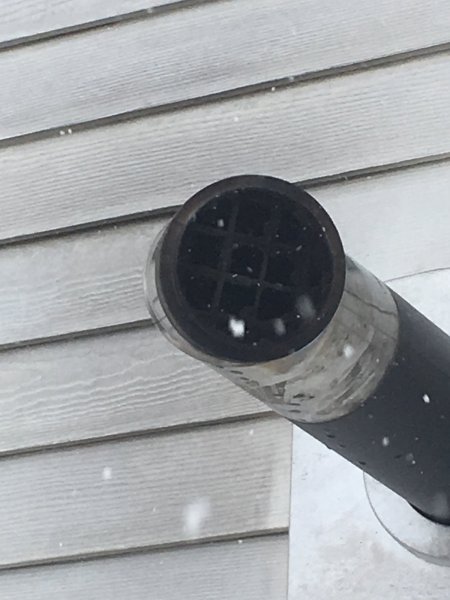

    IMG_3215.JPG The vent is pointing south and is turned away from the prevailing west by southwest winds. I turned it up a bit more than last year it seemed to help on the less windy days.

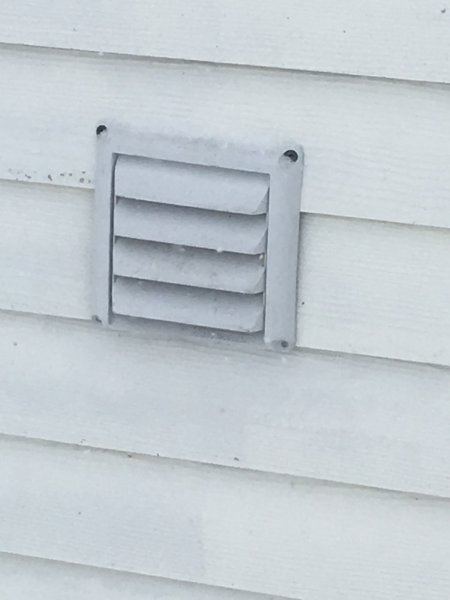

    CleanFire and ivanhoe like this.
  8. SmokeyTheBear
    SmokeyTheBear
    8,324
    39,419
    Standish, ME
    Looks like the air that will enter that Oak during a gust is not going to be enough to counter what enters through the vent, what is behind that Oak termination? Your wind sheild should be about 1' wide and 3' directly in front of both the OAK and vent termination.

    If you add a 45° vent piece that will help tremendously. My vent is almost the same, but I have Selkirk DT. So my vent and OAK is all one pipe.

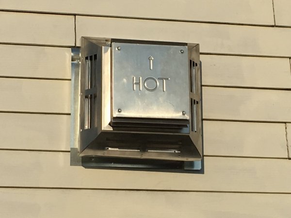

    Last year I put a (normally) vertical mounted stack cap over the termination piece. The conical shape extended by several inches in total diameter than the termination piece. I had hoped it would dissipate the influence of the strong gusts. Didn't make a difference, even though the OAK was not connected at that time.
    I tried a multi layered, multi directional cap....didn't work. ***I think this was the clue to my future success. IMG_3102.jpg
    It was left over from another propane device no longer in use, so I threw this up there a few months ago and gave it a run. Had built in baffles and the same diameter pipe, though I would give it a go before building a large windscreen. Didn't work.
    What may be an issue is the terrain and the various extra influences on the prevailing winds. The barn, large blue spruce (intentional wind break), the rise in elevation with a large stone well breaking the ever present trade winds off of our surrounding lakes and water ways.
