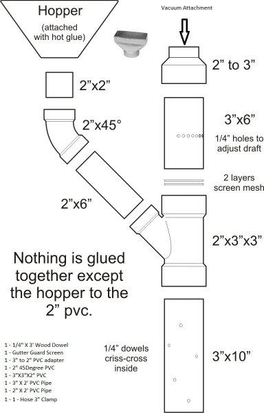

    Here you go...a bit crude but works

    Here was the one I built. . 1/4" dowel rods placed in the end of the drop chute makes the pellets bounce and knock all the fines off. Then a piece of mesh or gutter gaurd at the top keeps just fines getting sucked up and no pellets. If pellets are getting sucked up to the mesh, then you need to drill holes to allow less suction.

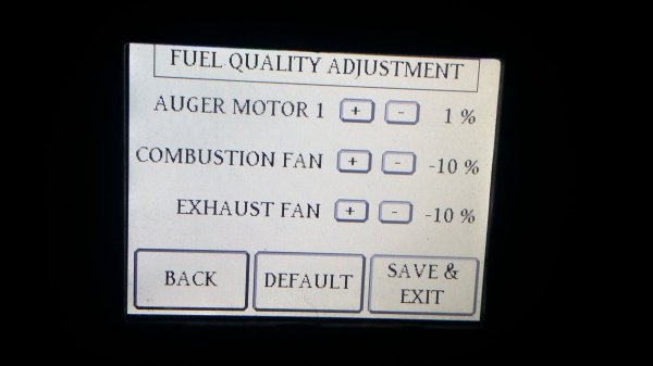

    My burn has always been good (to good). Even at its lowest settings.
    I run my Enerzone at -10% combustion blower / -10% exhaust blower / +1% auger.
    And I still have so many small pellet bits blown from the burn pot. My hopper always has dozens of little glowing bits of pellets :( And I can't slow the air down anymore. I thought my Quadrafire had to much air flow.... This thing is ridiculous! !
