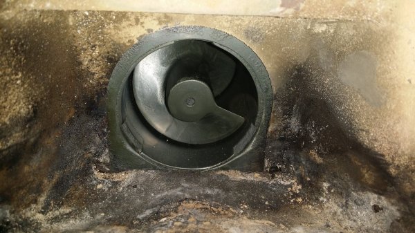

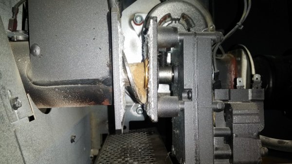

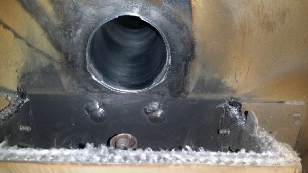

    Well, don't waste your time removing the auger and getting all the carbon. Mine went back a few inches.. Thought that I had 100% fixed it.. As soon as I hit start? It started the vibration/harmonics noise!! :hair:
    Pics of removing auger, polished auger flight, and pic of auger flight and auger with Dry Moly.
    There was all kinds of fines built up at the back of the auger, but I lubed it from both sides when it was out and removed all the carbon and polished the entire auger and auger flight/shaft!

    Wow, that is disappointing. Just about as disappointing as hearing nothing from the dealer. I picked up more LG's yesterday and he didn't say a word about our conversation on Saturday, when he stated he would call the factory and talk with his repair guy on Monday or Tuesday. "Tuesday" wasn't yet over, BUT I don't have a good feeling about his concern. Based on other conversations I believe he knows that this has been an issue and is just being demur about it. I sense a call to SBI coming.
    Let's keep this in mind: I cleaned the end of my shaft, oops :emb:I mean the auger shaft. I applied spray graphite to the shaft and auger and the noise was abated for about six hours.
    I have been revisiting this in thought, and trying to perceive where the noise could be coming from. Your experiences and pictures have led to the following thoughts and questions:
    I had wondered about the amount of fines dropping down from those crap Maeder's. They did have an inordinate amount of dust straight from the bag.
    Where would it all go? Obviously down the upper auger shaft 1st. How would they acumulate and or disperse?
    As the pellets move into the second feed auger, would all of the dust push out as well. Probably not, and as we can see in your photo, they do accumulate? I assume on the shaft and tube?
    You cleaned the surfaces of the auger and shaft but the noise still returned. So did the fines work themselves into a sealed bearing? Creating a sludge within the bearing, which causes the vibration to occur in a less predictable harmonic rhythm? I've had bearings fail in industrial sized woodworking machines. If pressure pressed the dust into the seal or cracked the seals, eventually the bearing could fail.
    When I cleaned and sprayed graphite I had no noise for about six hours and it steady came back. Is it just a simple issue of a poor design?
    Perhaps the pressures within this operation have become too much for the design and construction of the auger motor and shaft. What we hear are the symptoms of a gear box that has become worn and has a much longer road to get to the point of total failure. What would SBI do for the customer whose unit is still on warranty?
    There's an answer somewhere, we just have to find it.
