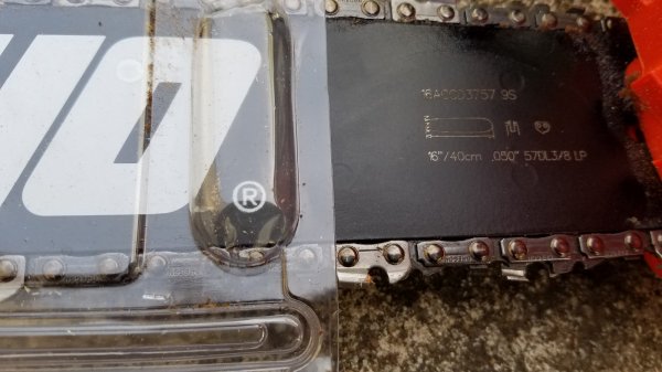

    This is what was written on the bar:
    12-10-N1-MHC
    Then under that was:
    BO *

    That does seem to be a 3/8LP bar, but you'd better count the drive links on one of your chains. Some references seem to suggest it's a 44DL bar, but information isn't plentiful so I'm not confident about it.

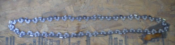

    Here is a photo of the current chain:

    Okay, then you need a 3/8LP chain, 0.050" gauge with 45 drive links. The chains you saw locally would be fine, as would the ones I linked to.
    FWIW, the chain in your last pic looks like it has a lot of life left in it, aside from maybe needing a sharpening.
  9. saskwoodburner
    saskwoodburner
    Dec 15, 2015
    2,606
    14,820
    I would agree, a non safety chain with lots of life left is what I'm seeing. When the cutter goes so far back it turns into a triangle when looking from the top, then it's ready for retirement.

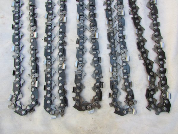

    Here's a pic of stock bar on my Echo cs 352

    Yeah, just trying to give ya an idea of what some look like
