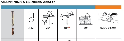

    What is this "10ยบ" spec you all are talking about? I know where the 30 & 60 are applied. Thanks in advance.

    "Offset 10 degree tilting vise for correct corner (or leading edge) angles on chisel cutters"
