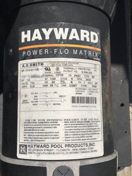

    Divide by the filter pump flow rate, so for my Haywood 1.0 HP motor and 2” hose about 52 GPM which is 3,120 GPH

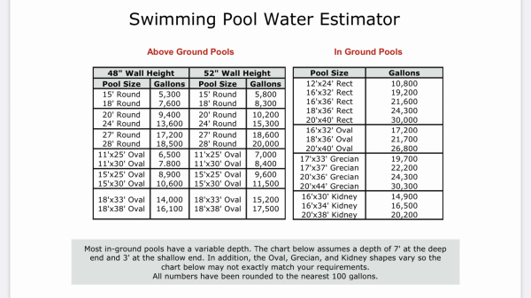

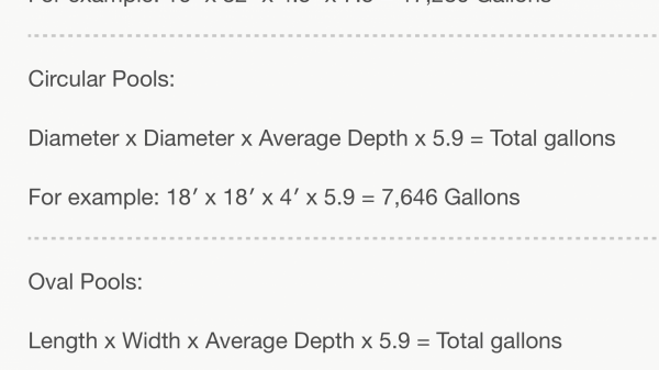

    I just checked another web site for the calculation.
    See pic below
    Mine is 52” deep which is 4.33 feet so
    18’ x 18’ x 4.33’ x 5.9 = 8,283.6 Gallons
    So this chart in this URL must be correct.
    https://www.orcity.org/sites/default/files/swimming_pool_water_estimator.pdf

    Yes, more accurate Don.

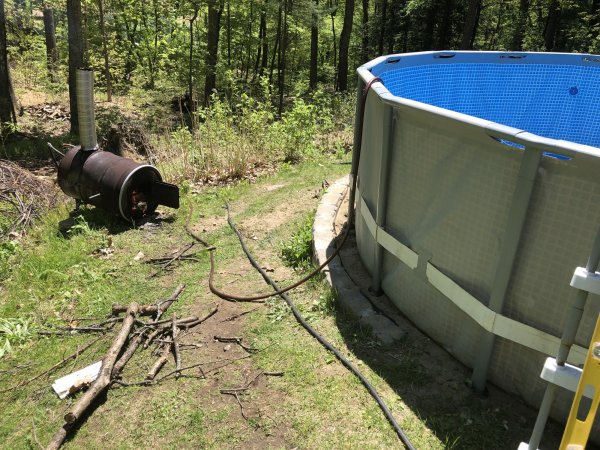

    Pool heater at work while filling. Raises the water temp by 10 degrees as the pool is being filled and operates on branch wood just fine... 60’ of copper pipe stuffed in there.
