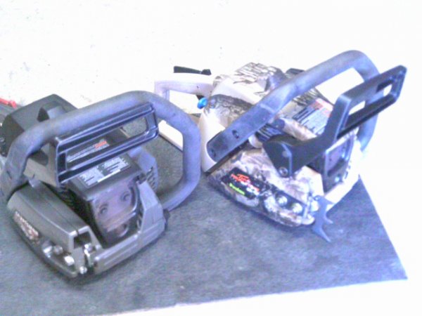

    Here's a spike I put on this REAL TREE version, it will fit both the strat and non strat saws, always check the intake manifold holding bolts, they tend too loosen on these saws I've found, also, opening up the outlets on the muffler helps, and yep, a good sharp chain. IMAG0144.JPG

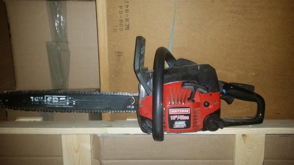

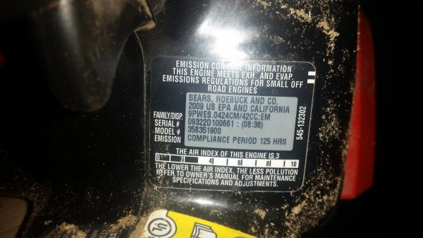

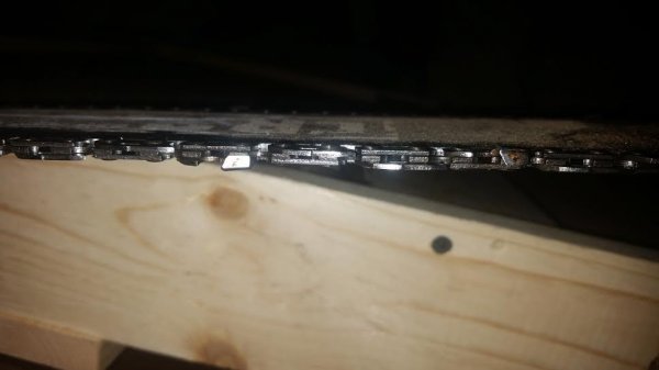

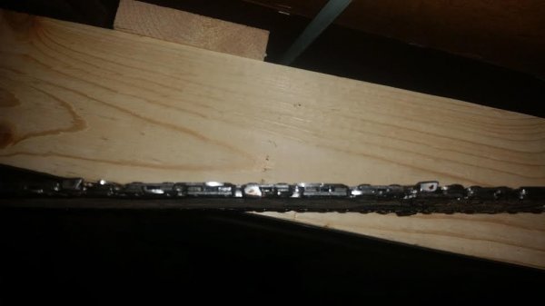

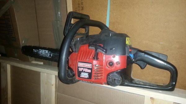

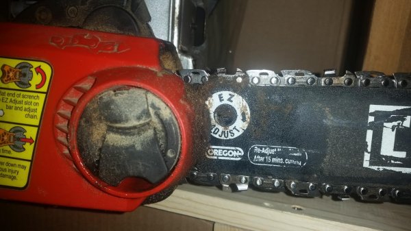

    I guess I went to bed too early last night and missed all of the fun. Thank you for all of the advice, so far, and no worries about the drifting. I should have known better and added the pics with the original post. I have already hazed myself and will know for the future. I have added some pics below, and please excuse the condition of the saw......again, I have already hazed myself. I think that I will hold off on the spikes, even though they do add a nice zombie apocalypse touch. I will inspect the bar further to make sure that there is not any crazy wear, or bending. I looked into the Oregon 91VXL062G and was going to go with that one, but was concerned about the greater chance for kickback. I am still new, so I wanted to make sure that it would not run wild if I switched to a more aggressive chain. The pics of the chain are not great, but I am picking up a file setup tomorrow. Thanks again for all of the help.

    Dont beat yourself up. Saws get dirty. That chain needs to be sharpened at minimum. Great information about kickback here:
    http://extension.missouri.edu/p/G1959
    If it were me I'd go with the 91VXL062G and just be aware of what causes kickback otherwise the chainsaw will operate the same as befor just cut much faster.

    That chain looks pretty bad. The shark fin bumpers are a big detriment to cutting. I'd sharpen it and store away for when you want to cut real dirty - eg: stump. And buy 91VXL. I like Frawley's, Lone Star and Left Coast Supplies - all can have good deals. And I'd turn L screw 1/8 - 1/4 turn CCW to richen. I'd give H screw 1/16 - 1/8 turn CCW just for good measure. And Idle/TAS screw should be in - CW - till chain just barely doesn't spin.

    I think that I will order a chain, or two, from Frawley's. I have read lots of good things about the Oregon 91VXL062G and think I will give one a try. While waiting for that to arrive to my little piece of mountain heaven, I will pick up a sharpener and clean up the saw and chain. I will post a couple pictures of the "after", now that you have all seen the "before". I want to see if adjusting the carb will fix that issue, as well. Any recommendations on replacement brands for spark plug and fuel filters? The manual calls for a Champion, but did not say anything about the fuel filter. I will blow out the air filter and get the body nice and clean, too.
