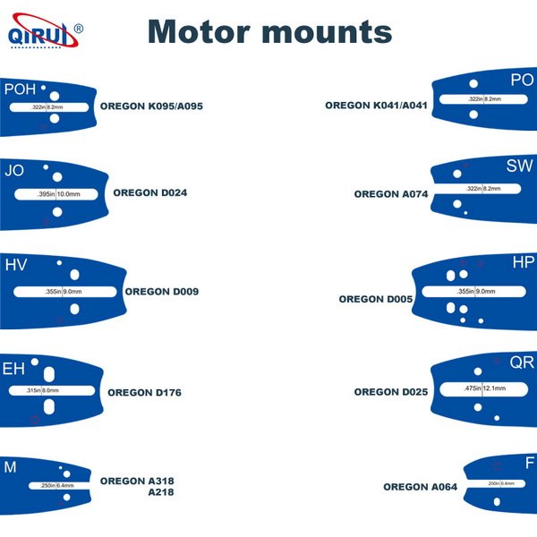

    Bar Mounts:
    Almost all Poulans 42cc and under are A041.
    Small Mount Husky is K095
    Large Mount Husky is D009
    Old big MACs are D176.
    New small MACs are A318.

    o_O Well I just learned something new. Thanks for giving me a visual. I do better with pictures, I was a Marine, after all.

    This would be better with some brands and what makes sense to us there. Like small mount husky etc. I always forget what corresponds.
