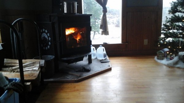

    yeah this is so true.. if your wife likes to a glass of wine after work... it according to my wife very romantic! I loaded my IS at 11 am because Saturday mornings we all curl up in master bedroom and have family time....so an easy 15 hours.. 8 hours later she just asked me not to fill it for nite as its too warm... over 8 hours later... there will be coals when I let dog out at 6 am...

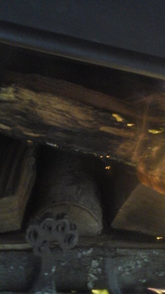

    OK this is after 25 hours I refilled 40 day 26 last nite.. did not take other pics sorry. opened air a t 6 am raked ash into pan at noon and filled 10 minutes later
    Stt was 150 ish

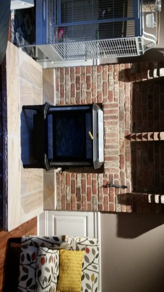

    well I pulled the trigger back in June and got her all hooked up last month. I ended up with the progress hybrid after visiting Woodstock soapstone. my wife loved it, me too. I ended up demoing the hearth to one course then pouring concrete, adding a steel beam in the basement, and going with rainbow stone for the pad. thanks to all who offered input.
    question on the Tee snout into collar before I fire it up. I crimped the snout and used a ratchet strap, around the T and stove with 2x3's to spread the load, and got the thing pretty tight, then screwed it in thru the collar. I held a lighter around the collar to snout and I'm not seeing and leaks. do any of you guys see anything wrong with using a strap to get the tight fit? note, I did not go crazy like strapping cargo in my truck. I was able to pull on the strap and gain a little movement. with strap off and snout screwed on there is no movement in my tee/liner.

    I'm not sure what part you call the "snout" but it doesn't have to be air tight anyway. It should have enough of a constant vacuum that the air will be going the other way. The important part is the screws in case of a backfire. So always remember to screw your snout.

    Congratulations! Got any pics? How many sq ft do you heat?

    lol, you calling my wife a pig

    69
    07806
    2400, but it only needs to keep the upstairs above 58, we are never up there anyway. at some point I'll have a custom cover made for the fireplace opening, unless I can find something pre made. I'm also 2"too close top my mantle, I need a heat shield.

    Looks great! I know the birds aren't going to be worried about being cold this winter
