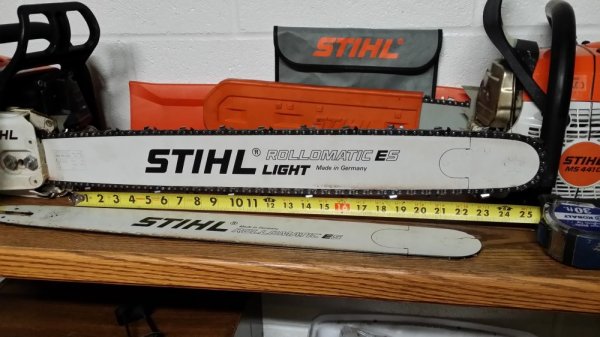

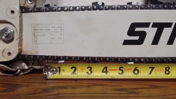

    X2... Exactly what he said on the chain...
    As for the bars? The 28" bar is only 25" to the tip. The 25" is less than 23" when using standard Dawgs. Use R dawgs and its less than 22"
    Both the 25" and 28" will pull full comp. So no need in buying any skip, unless you just want less cutters to sharpen.
    Here is a pic of the 28" on the saw and thee 25" lined up underneath it. The tape is at the end of the dawg (small dawg) and it's about 25.5" to the end.

    Is that skip chain on the 28" there, Dex?

    That's skip in that picture. I like semi skip best myself. I'd go 28" over 24" also. It's only 3 cutters with full comp.

    Yeah. I ordered some chain and messed up on the order. That 460 doesn't need skip until it hits around 36" :)
