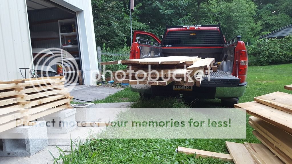

    Here's the total of the lumber we sawed today in the bed of the truck. The pile on the right of this pict is the shorter boards from last week that I had to take off the sticks to put thoday's 12 1/2 foot 2x4's under them.
    I got everything stacked and stickered tonight, but it was after dark when I finished. Picts of the final stack will be up tomorrow.

    How long did it take to cut that amount ?

    4 hours including setup time for the mill.

    That's for the whole amount. The stuff in the truck we knocked out in about and hour this morning. Under ideal conditions, that mill can put out 600+ bd-ft / hour. I haven't done a final tally, but we probably did about 200 bd-ft / hr. That's still a little slower than the guy I used to have saw for me (same mill). He was lightning fast.

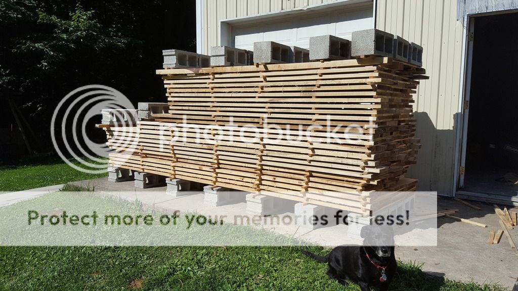

    Here's the final stack with Augie guarding it. .Time to let mother nature work her magic and dry it out.
    My final tally is: 924 bd-ft. That comes out to +43.5% Doyle, +15.5% Scibner and +5.1% International
    The final bill for sawing was $176, but I gave him and even $200. So, that comes out to 21.6 cents/bd-ft including tip. Of course, I have a whole bunch of "sweat equity" invested here, too. Super satisfied!

    A1+ stackin job too , there Mike :yes::thumbs::cool::salute:

    Now you know why it's so addictive! :cool: Ultimately, I'm a cheap bugger. :whistle: If I really wanted to get it kiln-dried, I know a guy who does it for 20 cents/bd-ft. However, I'm in no hurry, so I'll just let it air-dry to equilibrium. Then I can use it for anything outdoors. When I need it for indoor use, I can just bring the boards I need into the house a month or two beforehand and they will come down 8-9% M.C. Works like a charm.

    That's a nice stack of clear polar Mike:thumbs:.
    When I had some wood milled years ago instead of the cinderblocks I sandwiched the stack in Unistrut and all-thread. Allows constant tightening and no heavy lifting;)
    good idea to seal the end grain with some heavy roof coating or similar to save from checking

    All good ideas. This way works very well for me. The cinder blocks keep constant weight on the stack as the wood shrinks, so I don't have to keep tightening it like all-thread or ratchet straps. The ends were sealed with two coats of Anchorseal right after the logs were bucked. It dries almost clear. In the end, poplar is supposed to be very forgiving to dry.
