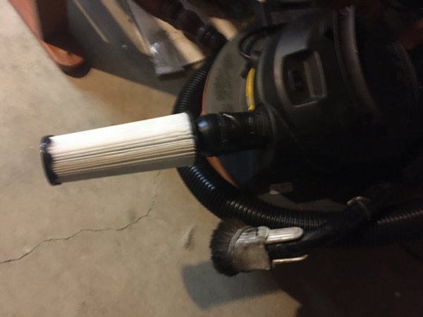

    IMG_4133.JPG IMG_4135.JPG Happy pre heating to all! Three questions....1) Does anyone use this Oneida system. There are some neat You Tube videos showing the system in use and my first thought is, Wow...it really works! At up to $99 bucks though it's expensive....but if your not replacing bags and pre-filters as much, maybe it's worth it???
    2) My main concern (as hard as vacuuming ash has always been,) what dust particles are exiting the exhaust on my shop vac? Unless I don't understand exactly how a shop vac works, I assume that some fine ash will always make it through to the exhaust and that is why I have attached a hepa Filter to my exhaust port....I have from time to time checked the inside of this Filter and I see no black areas........I still have a Power Smith vac but, I have found the bags very hard to clean and to keep ash from getting to the clean side of the filter.......Also I have notice black soot on the rim of the PS where the seal is suppose to be tight...
    3) Back to my Ridgid Shop Vac. Like most Shop Vac's the top always sits loose...Does air blow out around the edges or does it get sucked in?

    2) If you are not running a filter bag, or HEPA cartridge inside the Shop Vac (before the motor), it may be a good idea to do so, that will extend the life of the Shop Vac considerably. * The HEPA exhaust cartridge is also an excellent idea for keeping the room clean.
    3) On the smaller plastic shell Shop Vacs, when the motor is on, it is pulling vacuum and seals the top to the bottom canister - that's how they're designed to work.
    If the vac is old, or the seal is imperfect, it can leak air in, or blow ash out, depending on where and how imperfect the seal is.
    You can purchase some 3/8" EPDM weatherstripping from a local hardware or box store, and line that channel on the top (where it sits on the bottom canister) to get a better seal: this is what I did to the old converted 'filter canister' shop vac here, the top was pretty loose on the bottom canister due to age / wear. This fixed it, and works excellent here.

    I do run a bag and a Rigid blue filter. My add-on HEPA filter's inside is pure white so I'm not sure it's needed??? The inside wall of my shop vac does get a bit of "side wall" black ash over the season, the bags rubber seal is seated correctly between the two black ridges. I think I might try to seal the top channel.
