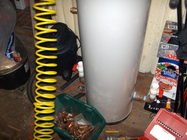

    Well folks, after spending much of the day cobbling fittings and adapters together, the Boiler Buddy truly looks like a Rube Goldberg machine, and the pressure test is under way..
    So far, so good: I'm satisfied the tank is intact and will hold pressure ok. All the fittings, adapters, etc. not so much. :picard:
    I.am.not.a.Plumber. Eesh. Pics:
    Apologies in advance, pardon the mess / trail of plumbing destruction shown.
    First pic is of the bottom of the tank: I went to Homey D. this week, and found 1 inch Sched. 40 PVC Ball valve fittings on clearance, 38 cents each listed on the box, and there were (5) of them.. They rang up as 1 cent ( .01 ) at checkout.. Sweet ! ( Those are the white things w/ the red turn valve on the tank. )
    The yellow coil line is from the small air compressor inside our front porch room, aka "Keebler Elf Workshop", running up to a fitting on the top "T" of the tank, that's where the air is coming from for the test. And the Boiler Buddy has been guarding the Beer stash.. Cool.
    Second pic is the top of the tank, air compressor line on left attached to a fitting embedded in a 1/2" PVC cap, right side is an adapter fitted to a MATCO Fuel Pump gauge .. ( Did I say this was a cobbled together mess? )
    That's the beer I am drinking right now. :D
    So the good news is that the Tank is holding pressure just fine, and looks excellent inside, aside from the rust found from the black iron pipe fittings installed, as received.
    Now comes the fun part of removing -everything- shown, and replacing it with Brass fittings, to eliminate any rust issue when the tank is in-service.
    I still have to post that schematic of how I think this will all look, I will go grab another Beer and work on that now. :D
    Have a great evening everyone. :yes:

    I resisted the temptation last night, before depressurizing the tank: in my experience, alcohol, power tools, & different sized pressurized vessels are generally not a 'good combination'. Chit usually 'blows up' when I try this stuff. :p
    That would have completed the ensemble here Mike, been fashionable, and functional. :thumbs:
    I think (one) of the reasons the original owner took the tank out of his boiler setup is because one of the original fittings has a pressure leak..
    * It's the fitting shown in the pic a few posts above, from the reverse side.
    When I pumped up pressure to 15 PSI, I could hear a (very small) air leak from the top output fitting. * If that was present in operation, it would have kept the boiler circulator pump cycling on/off constantly: I was reading a 4 PSI drop over 30 minutes.
    Regardless of the leak, I'm satisfied the tank integrity is good / it's worth spending the $$$ to purchase better fittings for the tank, & proceed. :yes:
