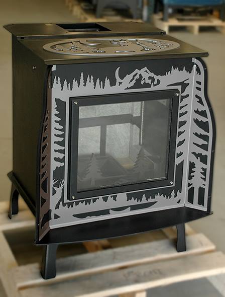

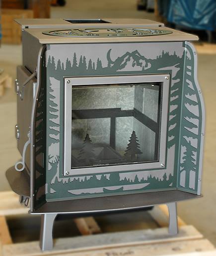

    I do think you are right looking at the AS and yes, you can still cook on it as you can with just about any stove. We have the Fireview and although nothing is mentioned about cooking on it, we have done that from the start. I think the reason Woodstock mentions the cooking on some stoves is that they are designed with a special place on the stove that is the best area for cooking plus designed especially for that. Look at the first picture below to see one made with cooktop design. But you can make it just like that yourself and enjoy cooking on it.
    The other 2 pictures are a couple of my favorites in the Absolute Steel stove, but I like the darker design over the lighter grey.
