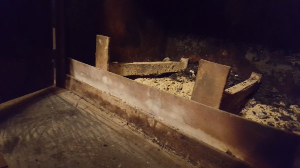

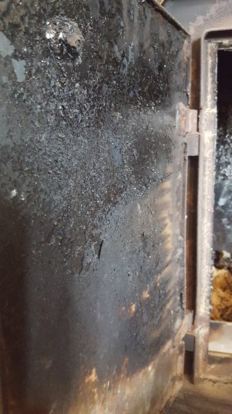

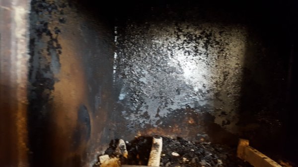

    I'm assuming this is creasote build-up? Should i scrape if off and get it out of the stove before using?

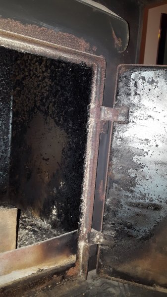

    Not sure if this is a channel or just lip for the doors to seat (or if anyone can tell from these pics)? I think i saw some flat gasket at the local hardware store... thinking about getting some and seeing how it fits unless yall advise otherwise...

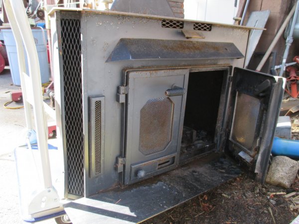

    Yes it is a recess. See the pic. It's what the edge and top of the door fits into, and at the bottom of that channel is where the gasket goes. The gasket for the bottom of the door is attached to a flat piece on the front of the firebox.

    That stove does look a lot like this one, just some small differences.
    Im not sure mine has what i would call a "channel". Its just flat where the doors meet up to the stove, with the edging around that. Dont know if you can tell from the previous pics i posted.
